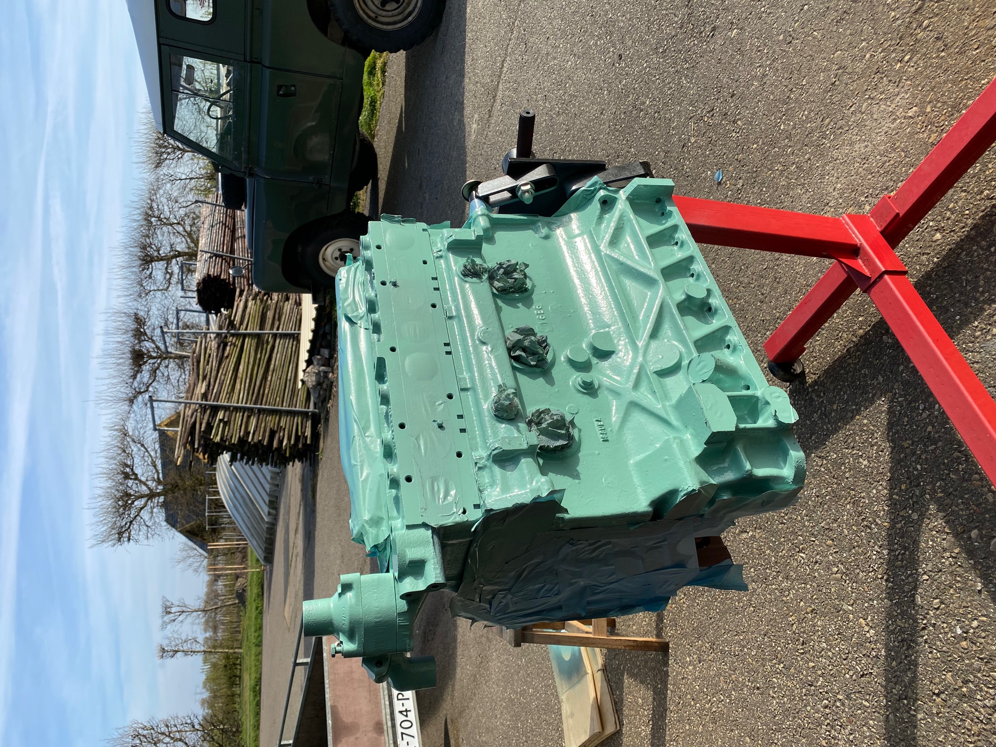

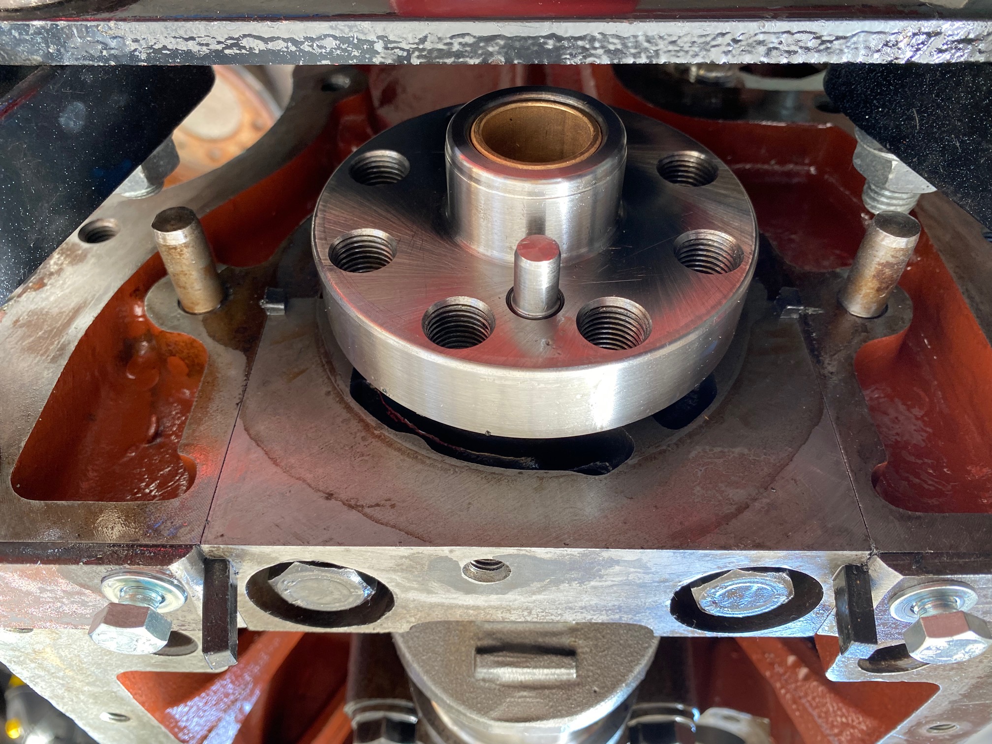

Inspection of the 2.5 block revealed that the crank needed grinding and it turned out that the cost of a new crank is close to machining so I opted for a new crank. Send of the head to ACR for porting and skimming and it returned with the over size pistons, H-beam rods, camshaft and the SU HS6 Carburetor kit.
Block was bored and skimmed locally during which I checked the dimensions of the new crank and cleaned, sand blasted and painted all ancillary parts.

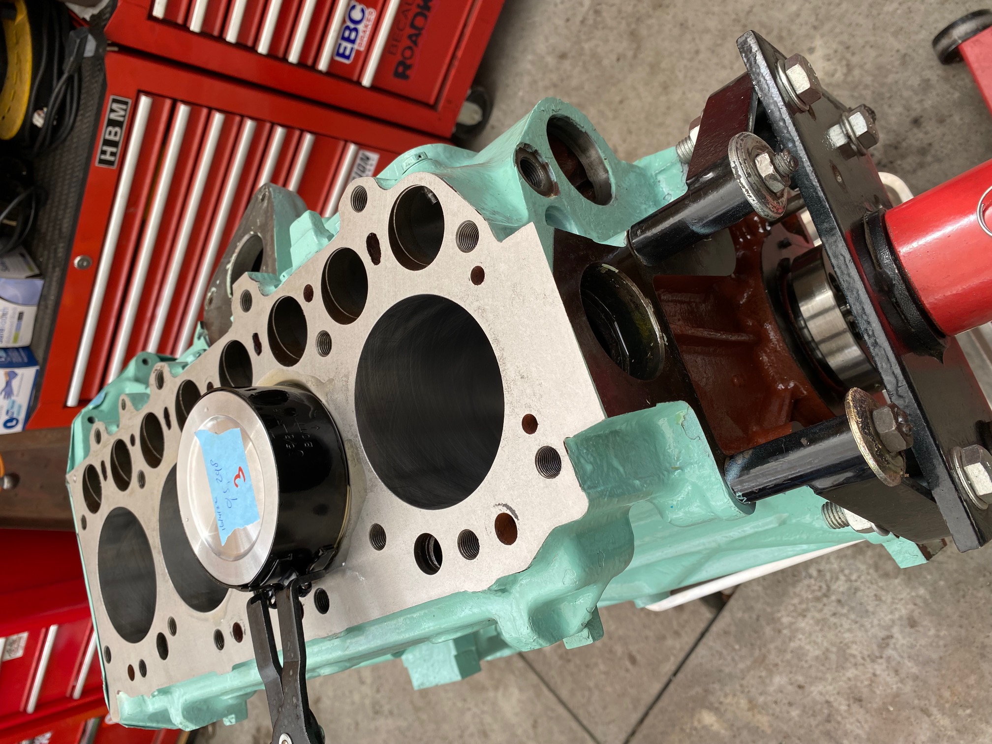

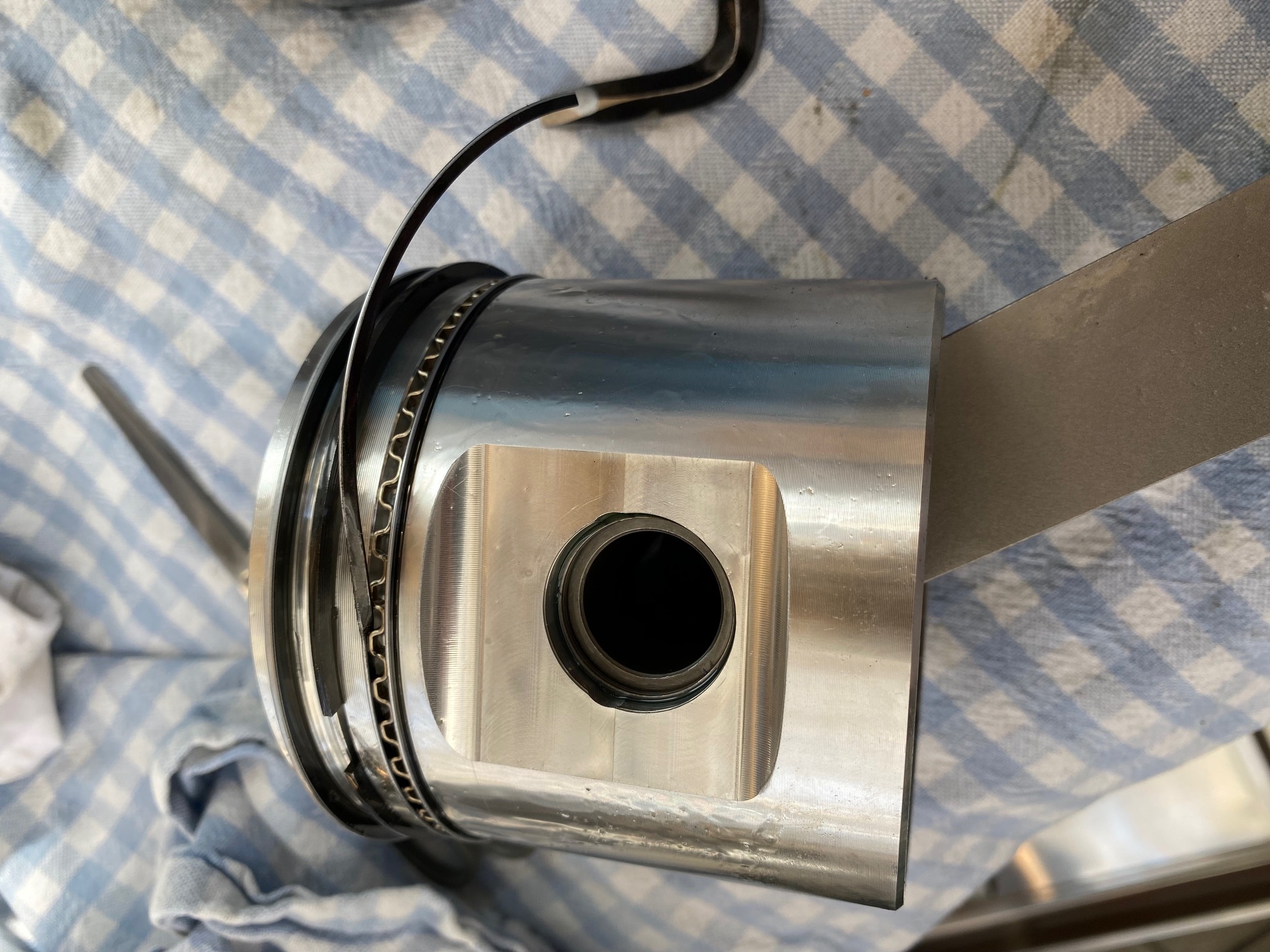

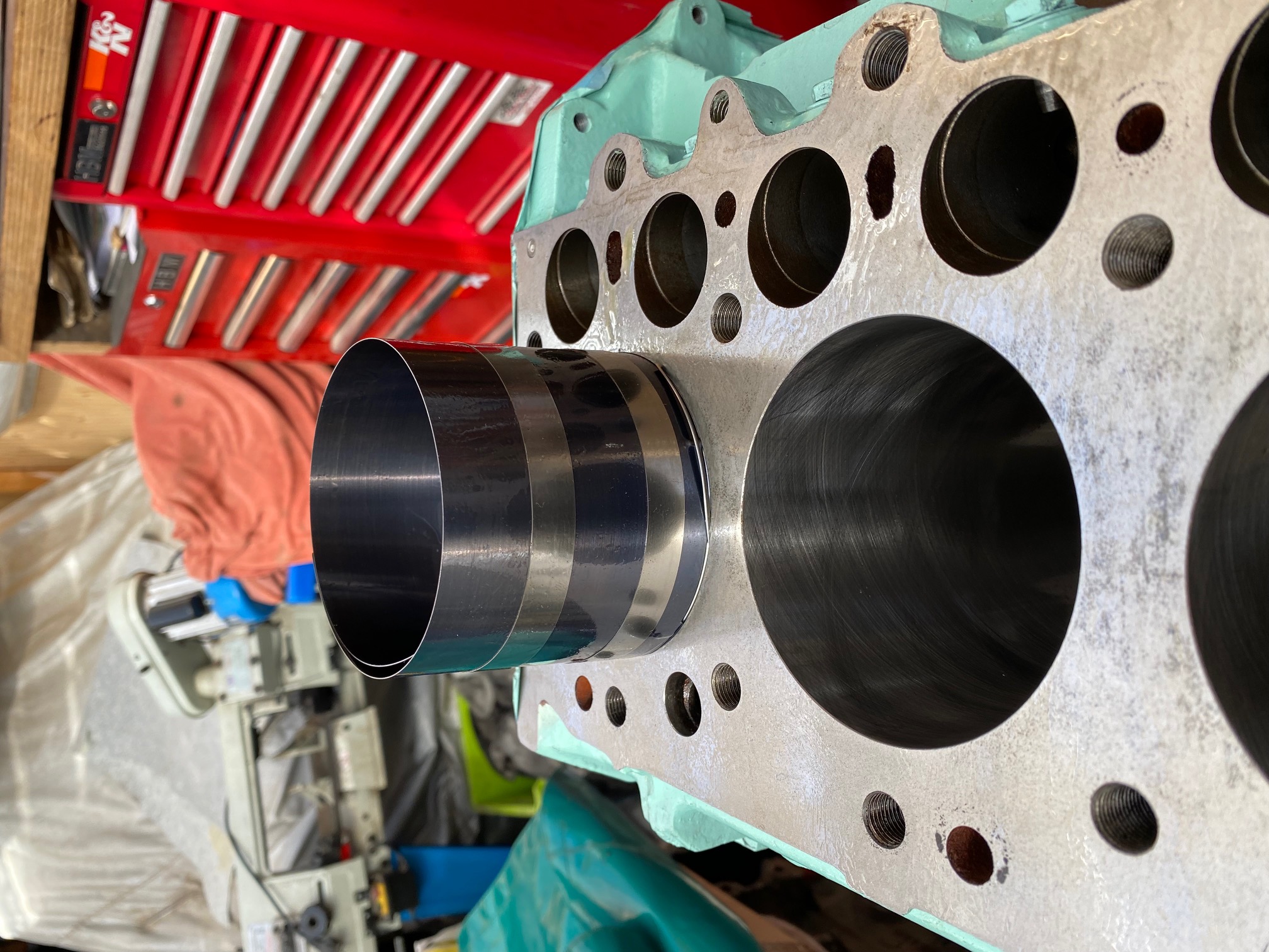

After return of the bored block it was painted too so the build could commence. Ring gaps and bearing clearances were checked and all within spec. When inserting # 1 piston the upper rail of the oil control ring snatched between the piston and cylinder wall. Possibly due to the type of ring compressor in combination with the large bore (95 mm). rail was destroyed and luckily only minor damage to the piston. Slight set back in time however due to waiting for the new rail.
While waiting I finished inserting the other pistons with another design ring compressor and inserted #1 piston without rings so I could start installing and timing the camshaft. More to follow.

- 3_New Crank-001.jpg (842.12 KiB) Viewed 1499763 times
- Quality check
- 3_New Crank-002.jpg (688.52 KiB) Viewed 1499763 times

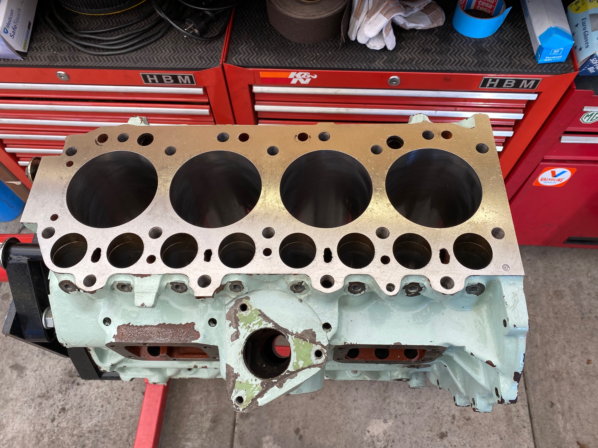

- Back from the machine shop, decked, bored and cam bearings fitted
- 4_Block_Machined-001.jpg (807.09 KiB) Viewed 1499763 times
- Paint!
- 4_Block_Painted-001.jpg (1.1 MiB) Viewed 1499763 times

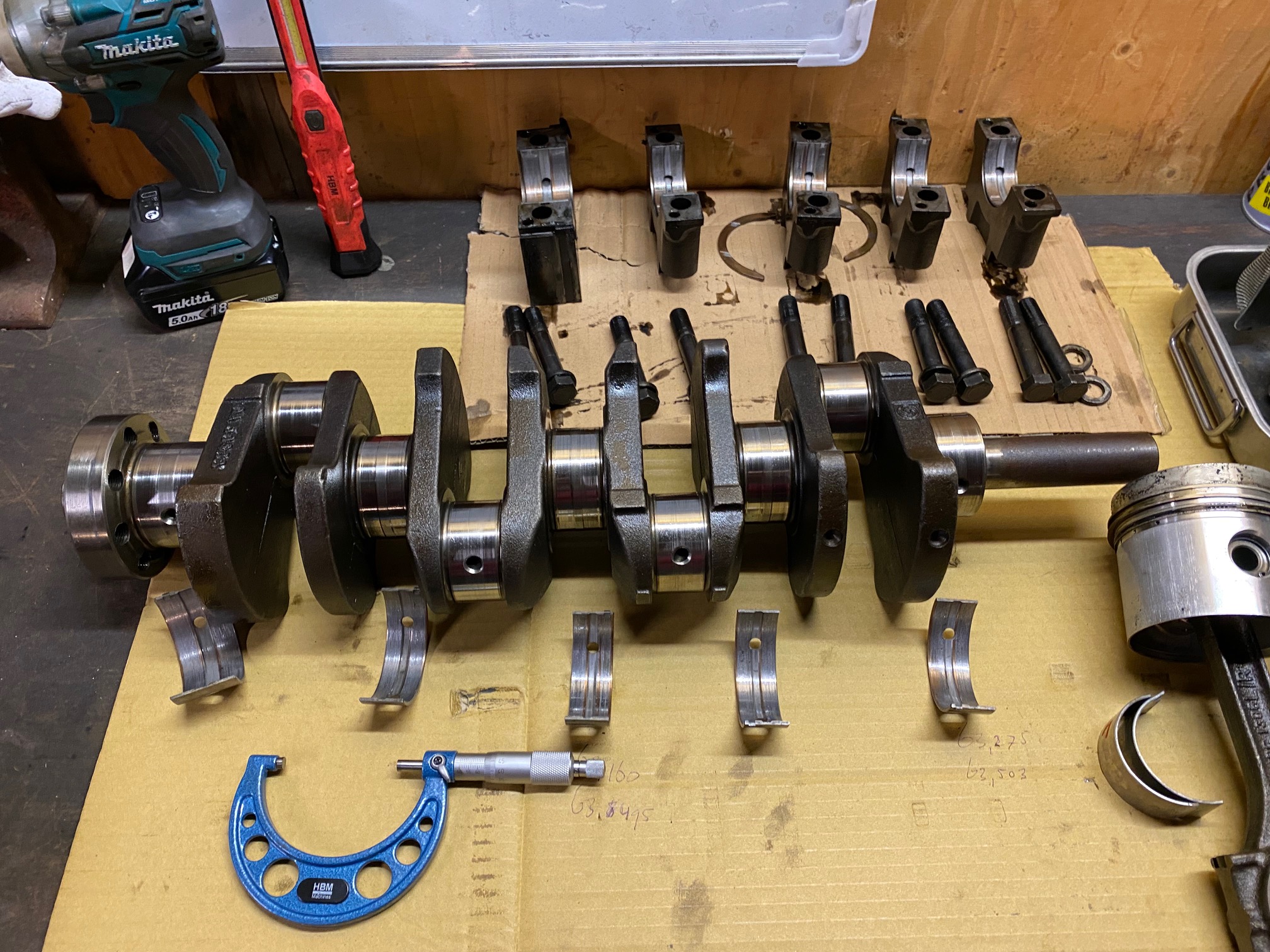

- Bearing clearance within spec
- 5_Rotary Assembly-001.jpg (629.85 KiB) Viewed 1499763 times
- Crank T-Seals fitted
- 5_Rotary Assembly-002.jpg (863.78 KiB) Viewed 1499763 times
- Crank end float within spec
- 5_Rotary Assembly-003.jpg (745.91 KiB) Viewed 1499763 times
- Fitting the rings
- 8_Pistons-001.jpg (748.7 KiB) Viewed 1499763 times
- Oil rail escaped
- 8_Pistons-002.jpg (661.08 KiB) Viewed 1499763 times
- Rail destroyed
- 8_Pistons-004.jpg (632.8 KiB) Viewed 1499763 times
- New ring compressor
- 8_Pistons-005.jpg (714.63 KiB) Viewed 1499763 times

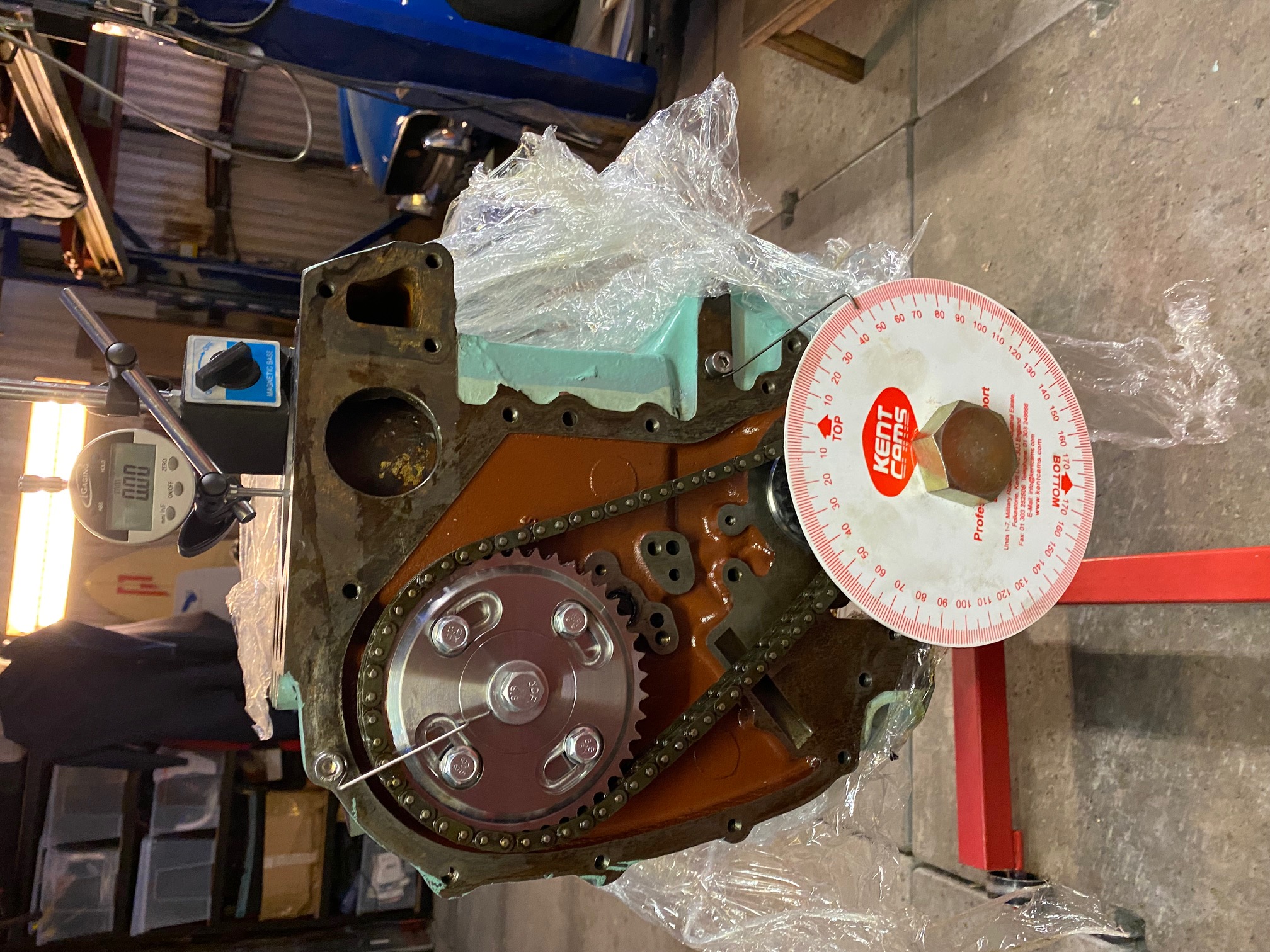

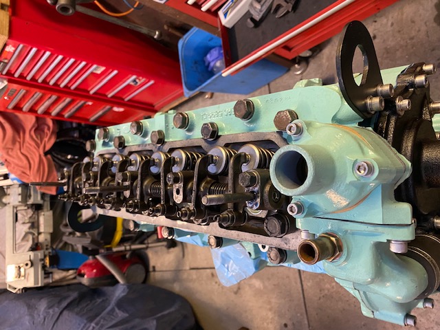

- Cam fitted, followers to go in
- 6_Cam-002.jpg (968.67 KiB) Viewed 1499763 times

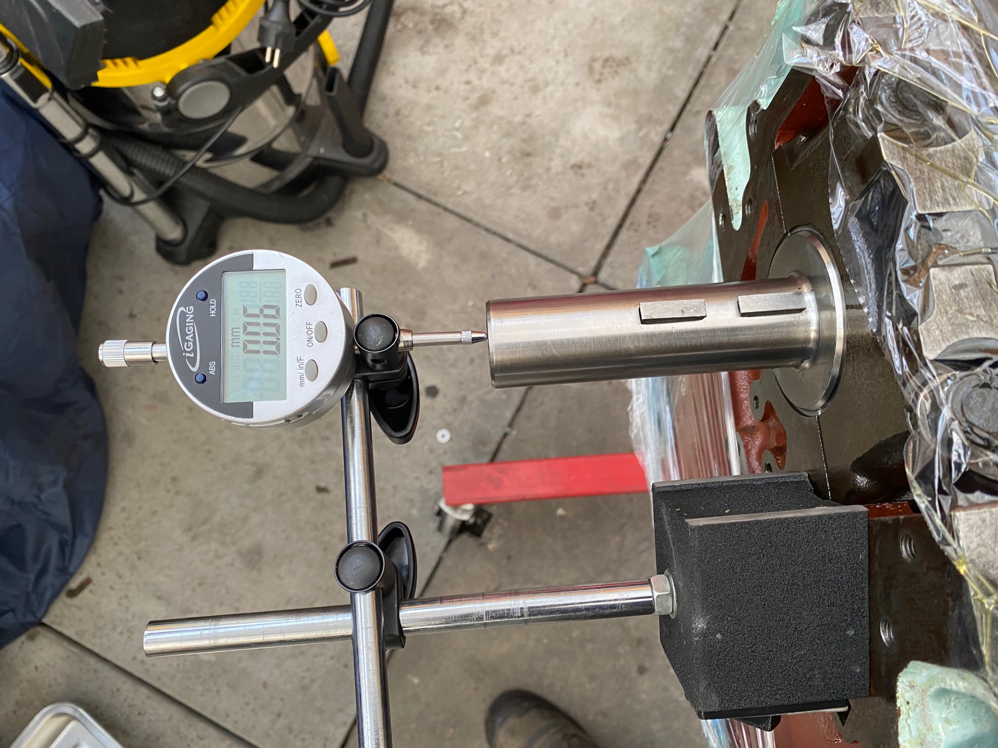

- Cam end float within spec
- 6_Cam-003.jpg (873.9 KiB) Viewed 1499763 times

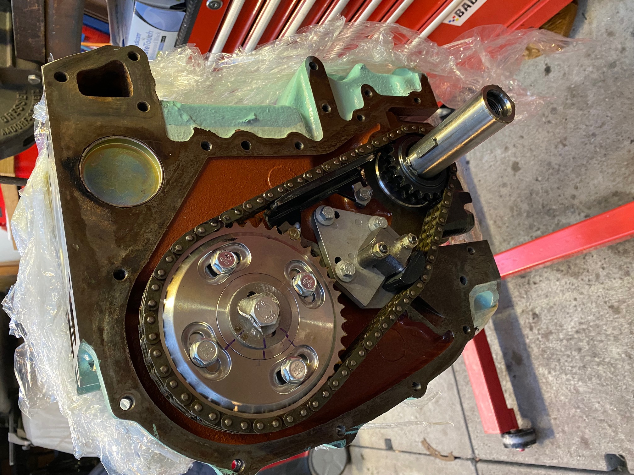

- Cam timed
- 7_Timing-001.jpg (866.99 KiB) Viewed 1499763 times
- All new parts fitted
- 7_Timing-002.jpg (883.01 KiB) Viewed 1499763 times

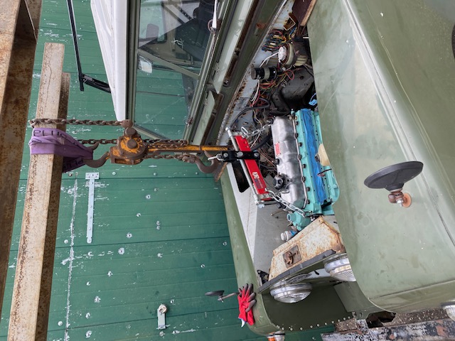

It has been a while since this post and a lot has happened. New piston rings cam in and I uneventfully finished the engine build. Took out the old engine, fitted the new one.

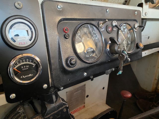

Since I will be running petrol as well as LPG I installed a Lambda Gauge to be able to tune for different fuels.
Commisioned the engine for first start up and drove away with a smile on my face: this conversion really makes a difference! Able to keep up with modern traffic and acceleration to 100 km/h does not take a week anymore ;-) Nor do hills slow down anymore.

- Old Engine out
- 14_Engine_in-001.jpg (109.62 KiB) Viewed 1498835 times
- New One in
- 14_Engine_in-002.jpg (137.72 KiB) Viewed 1498835 times
- 14_Engine_in-003.jpg (137.09 KiB) Viewed 1498835 times
- 14_Engine_in-004.jpg (129.95 KiB) Viewed 1498835 times

- 19_AFR-001.jpg (95.63 KiB) Viewed 1498835 times

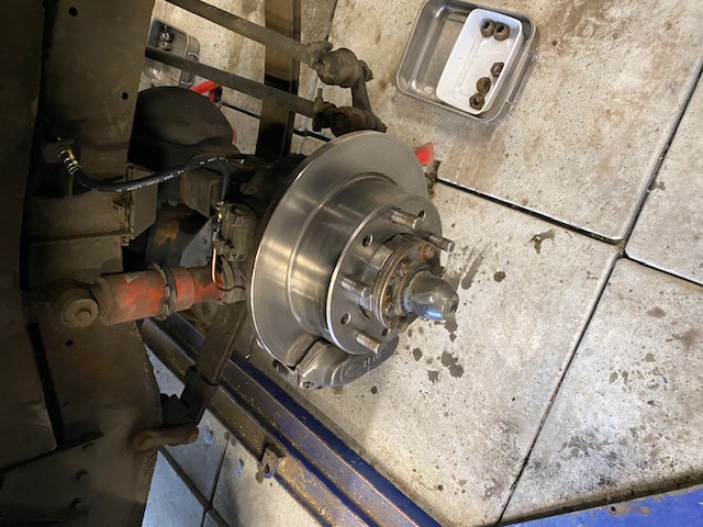

Almost another two years have passed. Latest upgrade has been the installation of a disc brake kit giving a firmer pedal and eliminating the regular adjustment needed when driving spirited.

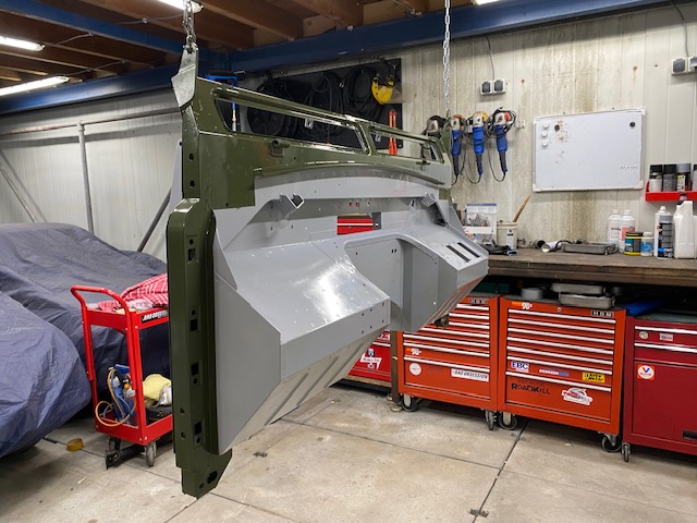

Finally I embarked on the task of replacing the bulkhead for a brand new one made by a specialist in the UK. I painted it myself and in the process also replaced the home made wiring loom that was made from wires as found in your home (installed by the previous owner). No worries over rust and unreliable wiring in the years to come!
- Brand new home spray painted Bulk Head
- 2025_LRS2_Bulk Head-001.jpeg (106.14 KiB) Viewed 15367 times

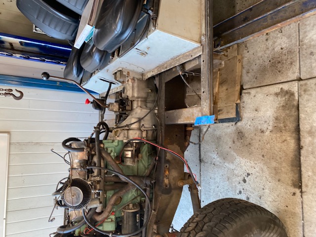

- All removed
- 2025_LRS2_Bulk Head-002.jpeg (109.98 KiB) Viewed 15367 times

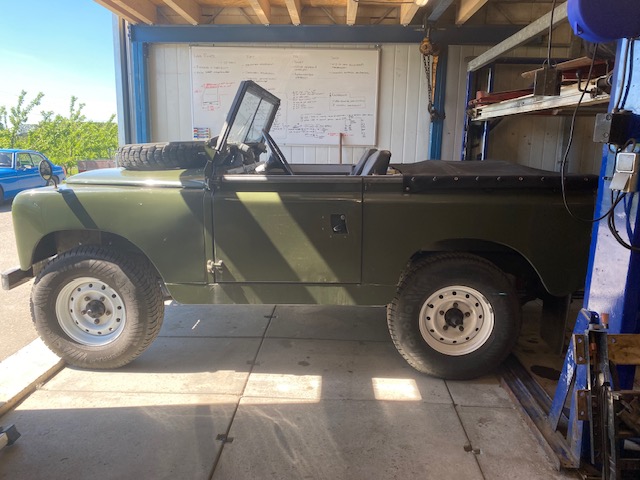

- Last picture before re-installing the truck cab
- 2025_LRS2_Bulk Head-003.jpeg (87.76 KiB) Viewed 15367 times
- Disk Brake kit installed
- 2025_LRS2_Disc Brakes-001.jpeg (113.46 KiB) Viewed 15367 times
