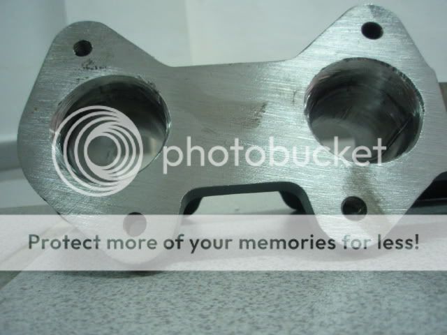

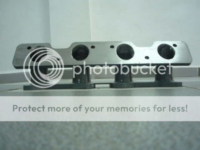

The day has arrived,
the manifold and Hi-Torque starter arrived today from Allinson Automotive, posted less than a week ago and tracked and arrived this morning.
Starter is a straight forward swop, see photo below.
The manifold is as specified, finnished in a grey semi gloss paint, welding is of an excellent quality.
The photos below show the manifold before and after fitting, note the connection on No:4 inlet for the brake vacuum take off.
The TB's are now at an angle of approx 22 degrees and forward by approx 35mm, previously i had little clearance box between the TB's and the bullkhead, now i have sufficient space to allow an air box to be fitted.
The manifold creates better access, and from a cosmentic perspective the TB's look better at an angle than they did burried down in the engine bay.
Steve
