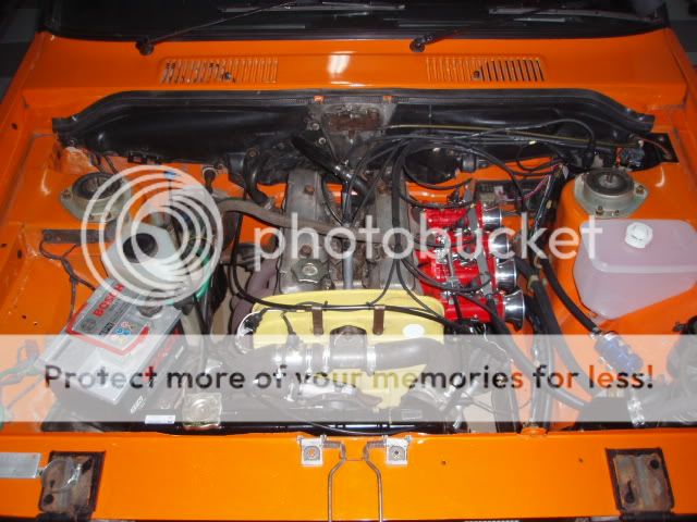

Im in the process of having a manifold made to fit a 2.0 twin cam cylinder head for a pair of Jenvey TB's (Throttle bodies).
The TB's are currently on a Guy Croft offset manifold, and are a direct replacement for twin Webers.
I need to get the TB's closer to the cylinder head, i also need to get rid of the offset which is causing me clearence problems between the last TB and the bulkhead, i have an Omex ignition system fitted so ive done away with the distributor.
I have someone who is willing to manufacture a manifold for me, however detailed dimensions of the set up are required.
I have the mounting hole dimensions of the TB's they are 110mm top 70mm bottom holes.
Im currently away from my car and wont be able to get back until August.
Apparently, and i was'nt aware of this, their is a difference in distance between the pair of carbs on a twin manifold, see question from manufacturer: Question: the problem is the spacing is different for the early series Webers and the later carbs. The 13/15 series are 3/4" closer together than the later 70 series carbs. We make either flange, so that's not a problem. I just need the dimension between the mounting holes for the two tbs.
So i can place the order and have the manifold at home ready for fitting in August im in need of the afformentioned dimension.
If any one can help it would be appreciated.
Regards
Steve
Ive attached 2 photo's of the current set up:
Parrish 366
