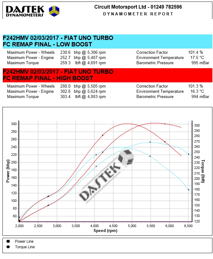

I am now the proud owner of a GC 1.9l stroker engine
the power and torque is just brutal and is a massive step up from the old 1300 engine, I have done a excel comparison and the new 1900 has more than double the power in the mid range, peak is 302bhp and 303lbft of torque

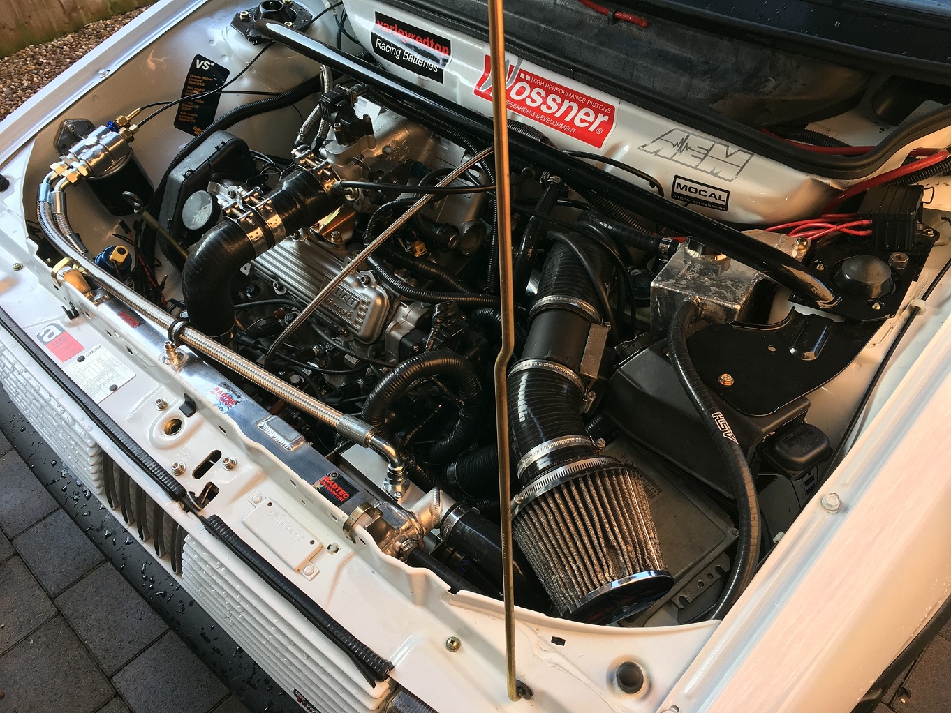

engine spec is
GC 1864cc stroker cr 8.3/1
piper 270 camshaft
gc spec cylinder head with 39.5mm inlet valves 33.5mm exhaust
arrow precision con rods wossner pistons
garrett gt2560r turbocharger
bosch motronic 2.7 ecu
siemens deka 630cc injectors
walbro 255l fuel pump
radtech alloy radiator
pace alloy intercooler
mocal lamionva with remote mounted filter,
racetech oil and coolant gauges
Thank you GC for making it happen.
dyno 1900.jpg (165.87 KiB) Viewed 145575 times
excel 1900 vs 1300 comparison.jpg (180.28 KiB) Viewed 145575 times

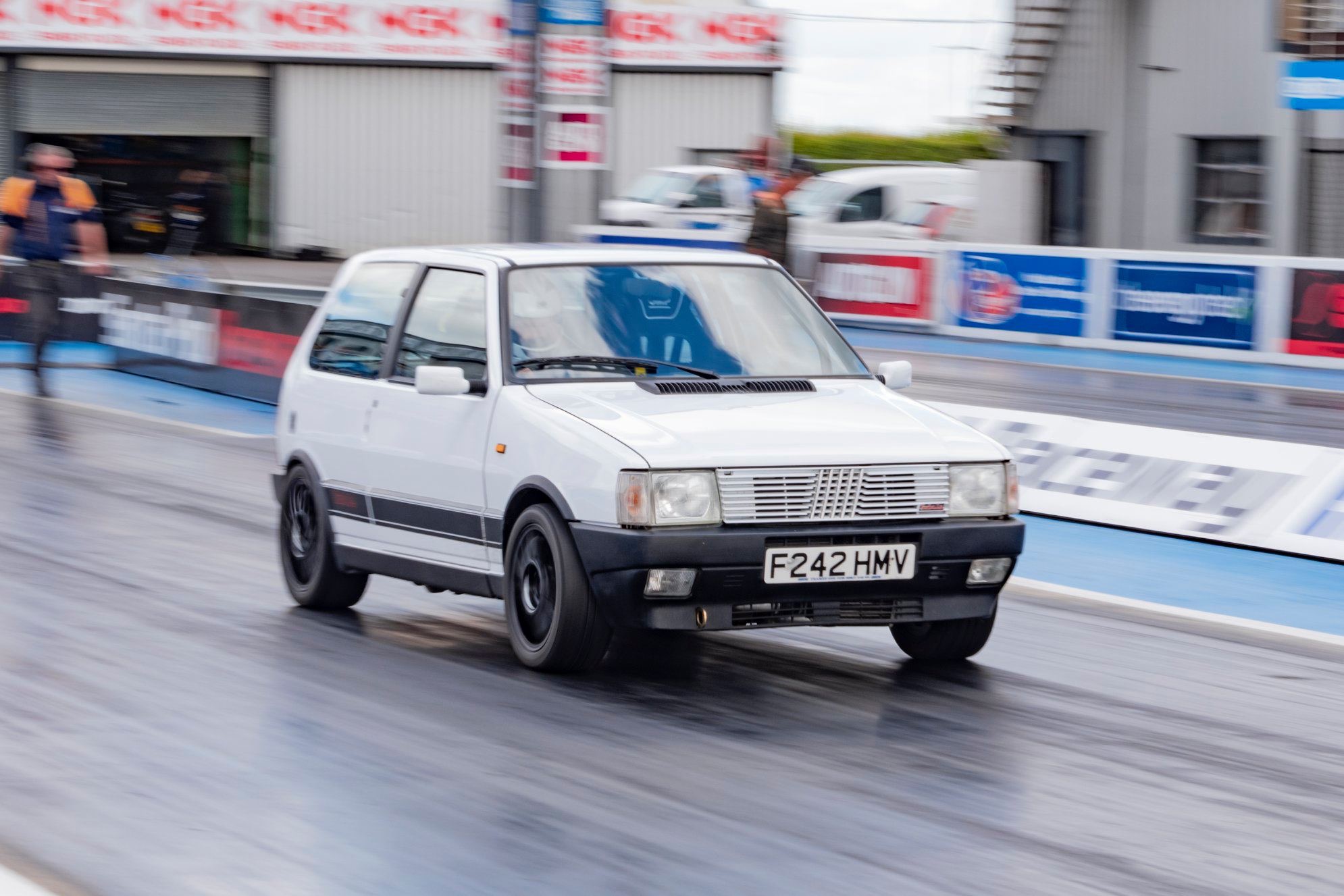

Retro Show 2019 I competed in the 1/4 mile run what ya bring Class C which is road legal tyres and under 2000cc with turbo or nitrous and won the class with a best time of 12.9@109mph, my friend Ben in his twin cam 8v powered white uno which you can see below set a best time of 13.2.
