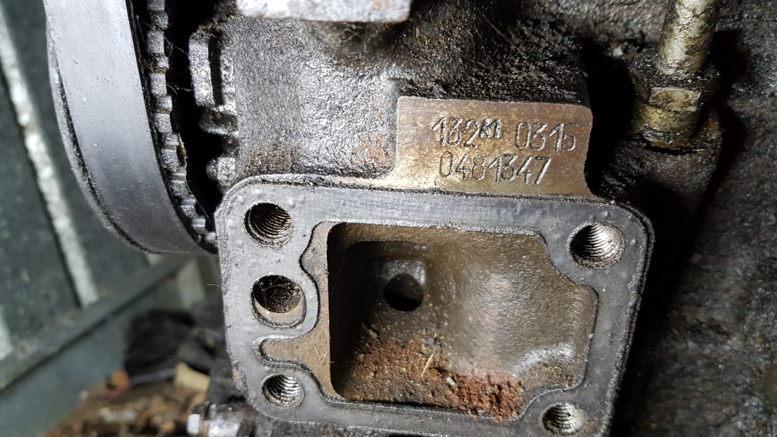

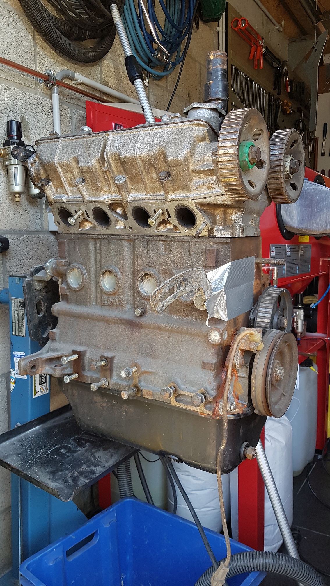

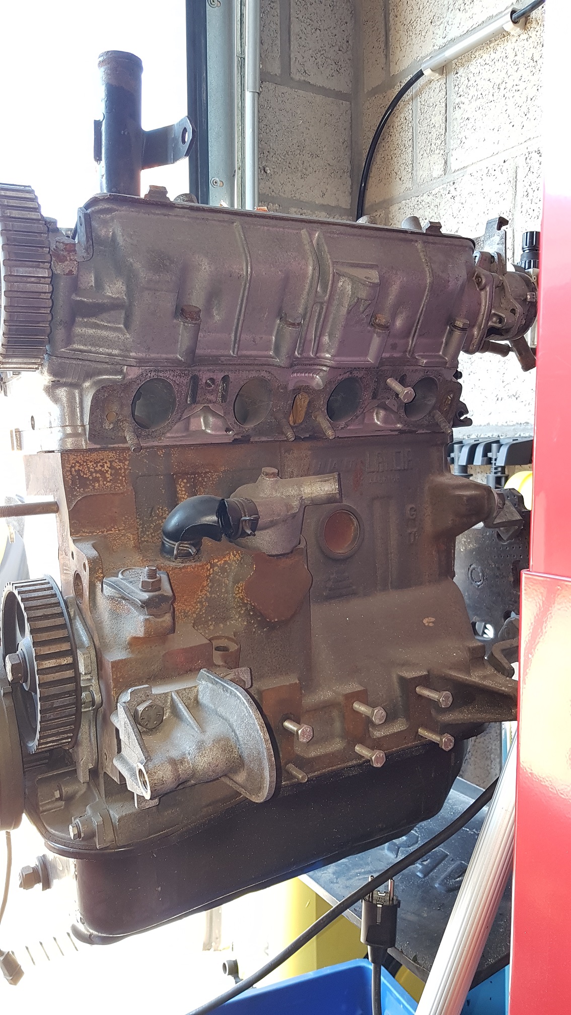

Motor Number
Motor Number

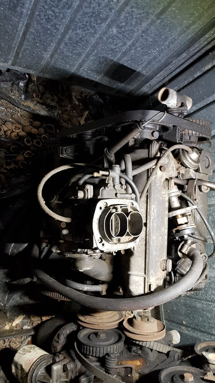

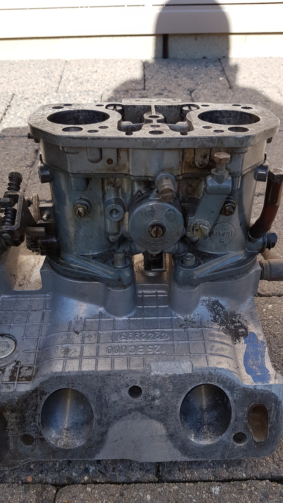

Intake manifold and carbs.
Greetings Baxter
Re: 130TC abarth motor upgrade for 131abarth replica
Posted: March 11th, 2019, 4:06 pm
It's hard for me to advise on this because all the things I recommend would be GC raceparts and I think the cost will not interest you.
If I were doing this engine I would strip the 130TC completely and the 131/132 spare too. If the non-130TC crank is in superb condition I would use that because you're going to have problems using the 130TC crank in RWD setup. However to re-use a good crank requires careful prep, all described in all the books I have written 1996 (reprint for sale on an internet auction site), 2010, 2013
The rods and valves, springs, pistons - I would junk. I never use cast pistons anymore, only GC.JE forged designs, same goes with the rods.
The 130TC had 3D mapped ignition with a distributor on the cambox end and even if that system was any use with a non-standard engine it won't fit the car so best use the 131 camboxes.
Ignition systems that will fit the unit - very limited choice. Now and again a new OE 124 distributor comes up for sale - driven off the top of the ex cambox. I can supply GC cams with the drive gear for that but finding a cambox with the port for the top-mounted distributor is not easy.
Carbs - well, if the car is left-hand drive the brake booster gets in the way of sidedraft carbs (for which I have a GC inlet manifold for 45 DCOE) so you are forced really to use the old 124 'waffle' downdraft inlet manifold but with that the distributor must be mounted on the ex cambox. I'm not going to get into distributorless ignition (that most of my engines use these days - with Omex system and trigger wheel). Not at this time anyway.
You'll need the sump from a 131/132 2 liter engine and an oil pump of that type too. I overhaul a lot of these, I am not saying just take the old one and bolt it to the new engine...
If going downdraft use 44 IDF from Webcon.
None of this stuff is easy to describe, in fact it takes hours, even for people who are GC clients.

Here are the pictures...

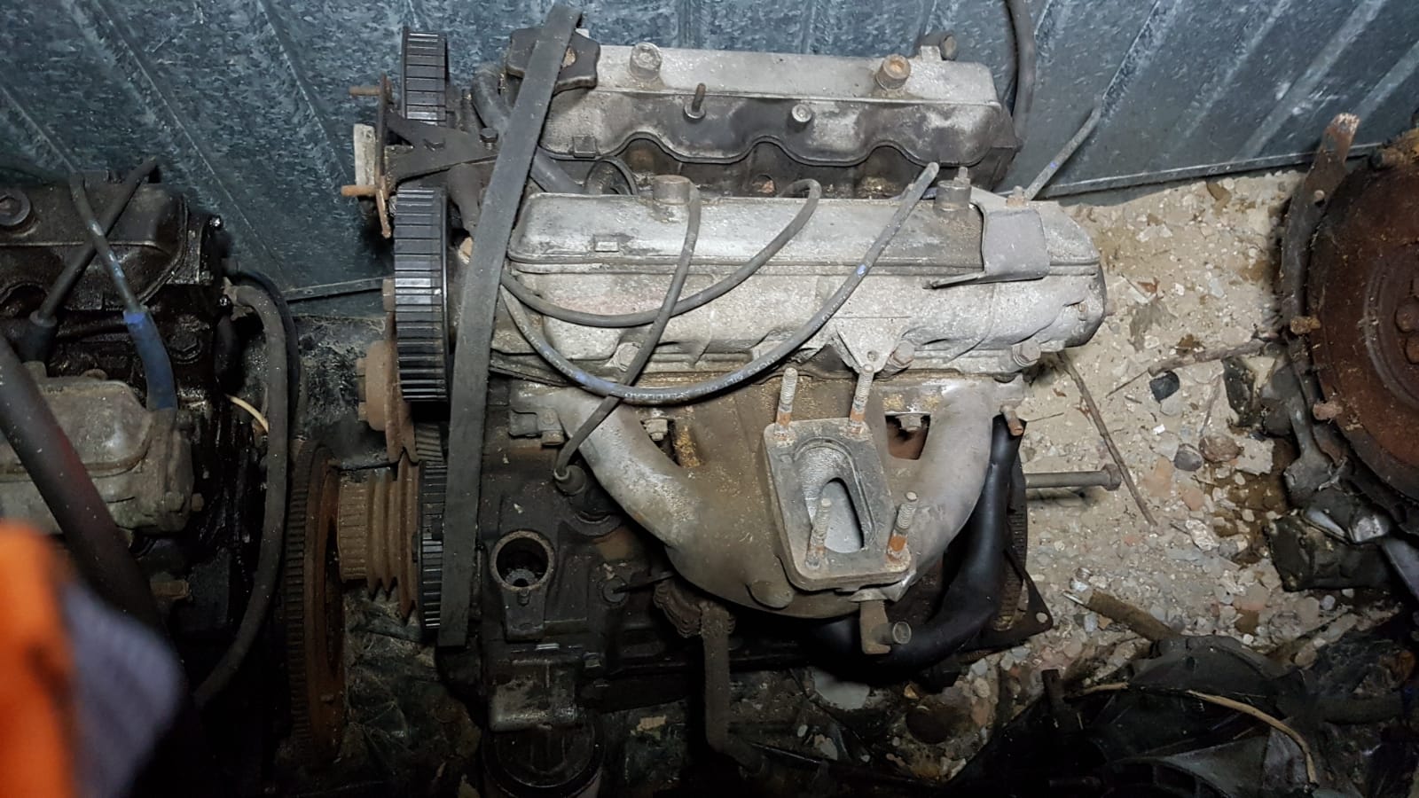

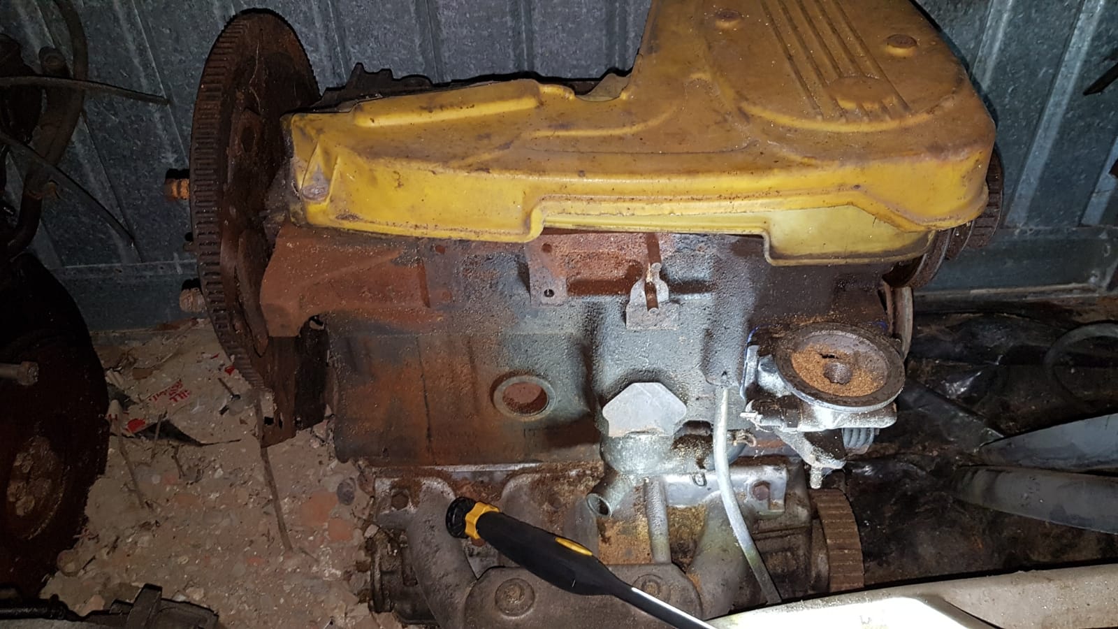

This is the first motor for parts.

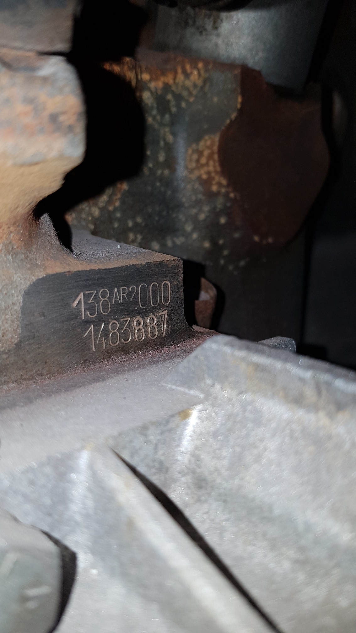

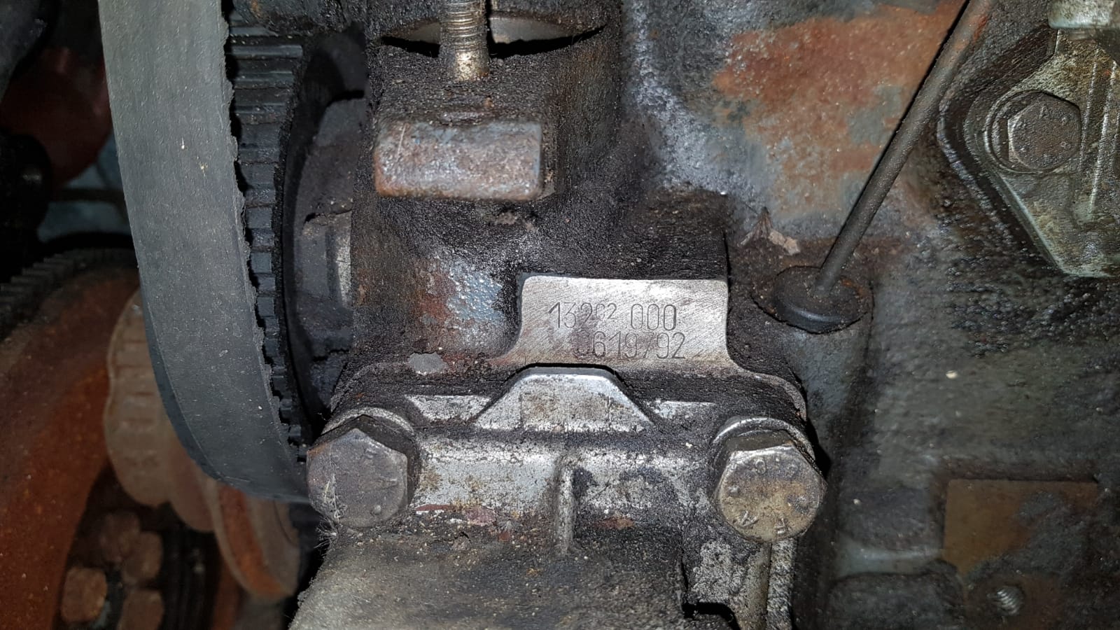

Number of the first motor

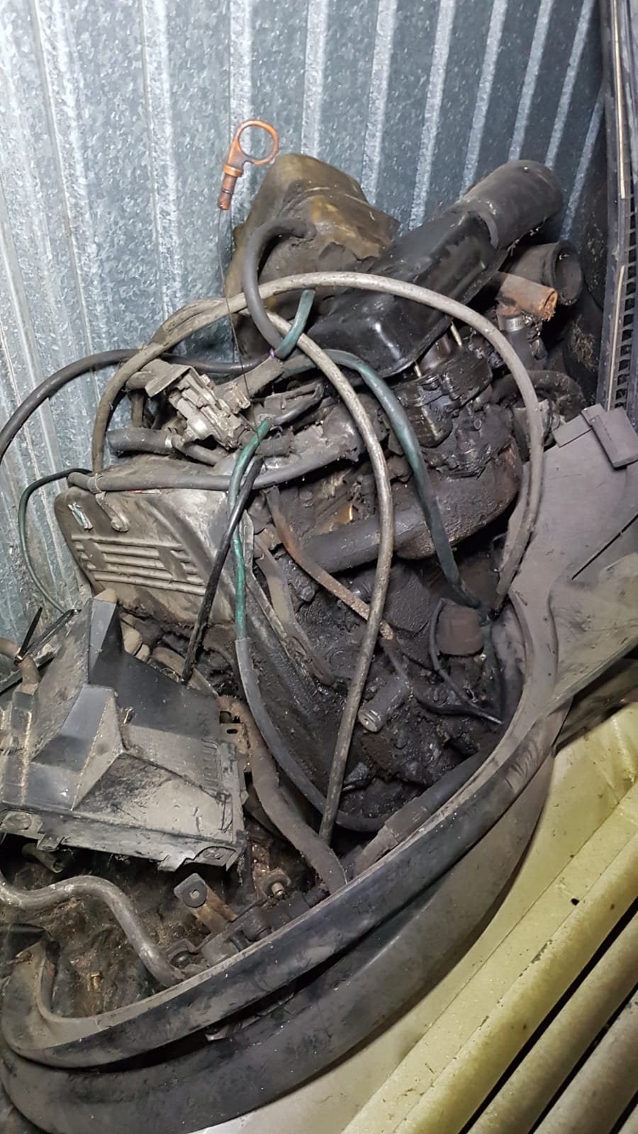

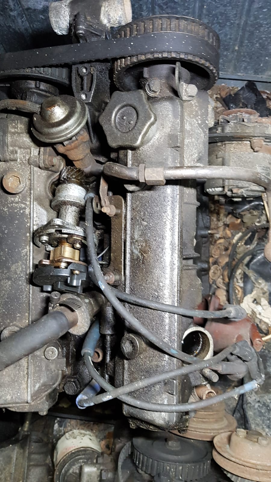

This is the second motor.

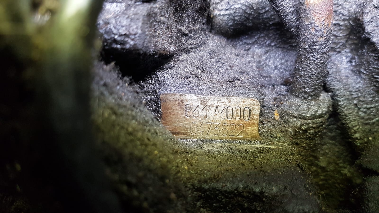

Number of the second motor.

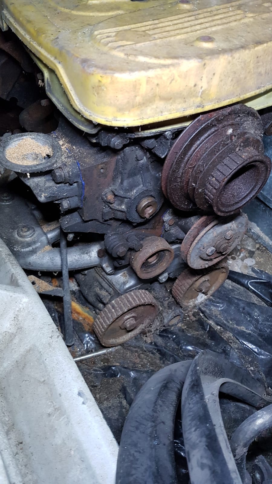

This is the third motor.

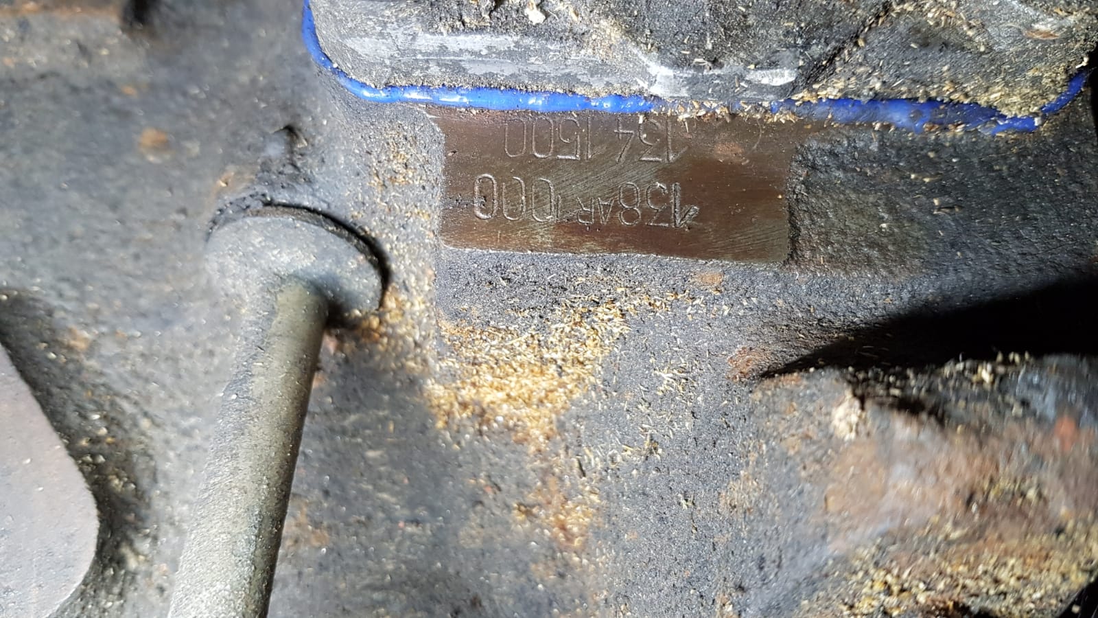

Number of the third motor.

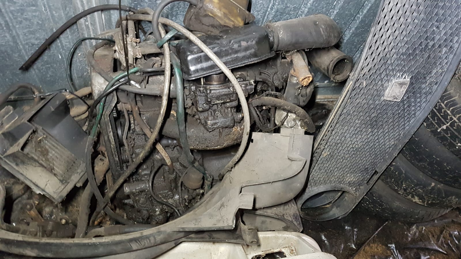

This is the fourth motor.
Number of the fourth motor.

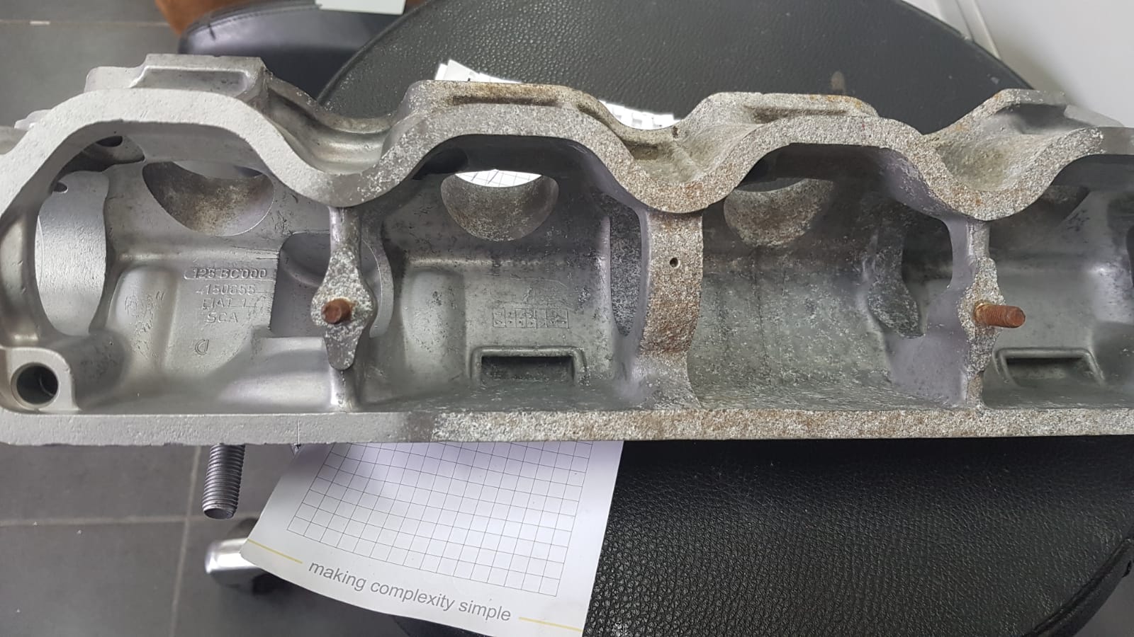

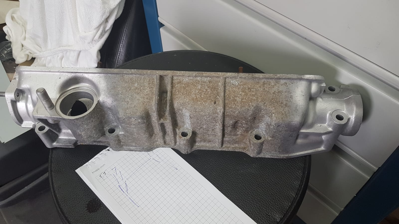

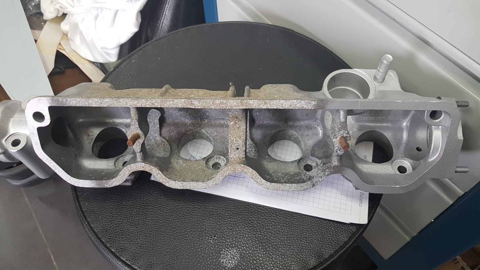

I also found a loose cambox between my parts for the distributor to place on top. But the alu is slightly corroded, can it still be used after sandblasting or not? Attached photos.
Cambox.
Cambox.
Cambox.
Cambox.
Cambox.
Cambox.
I already thank you for your time and hope to hear from you soon.
Posted: March 23rd, 2019, 9:32 pm
I'm not going to be able to guide you on this the way you are presenting it, the scope is way too big for me to devote time to. Whether you agree or not the reality is you are asking me what to do. I cannot at this time.
You need to completely strip all your donor units, clean and inspect the parts you're going to use for a start. This means working out exactly what you're going to use and NOT. The priority is a good useable 2 liter crank, by far.
75% of the stuff shown would be scrapped at GCE if undertaking a rebuild.
