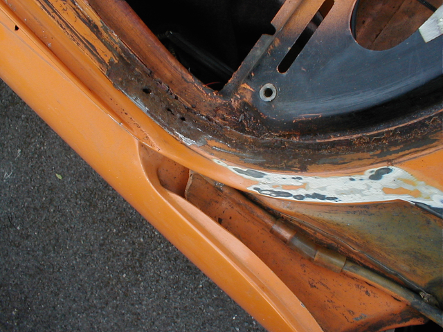

The aim now to get it back into a sound and nice usable and presentable condition with all the rot and paint attended too. I'm currently going down the 'junior' RS route as its the only financially viable way I can afford it. The car is currently in storage a few miles away but should be back in the garage by the summer for work to continue.
I've not really got time for full blow-by-blow build account of the rebuild, so I'll just post up some captioned pictures with the odd comment here and there. I'll start with some pics from the strip down back in '04

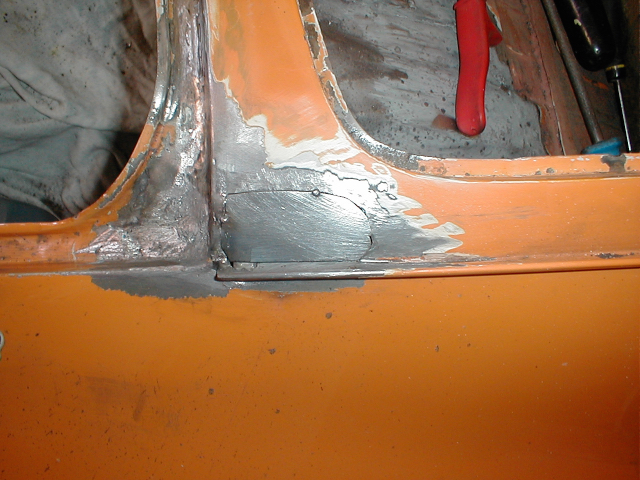

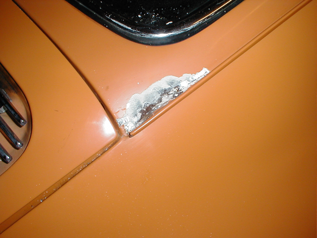

I knew about the filler covering up this area when I bought the car.

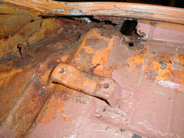

This (as I suspected) is what lay on the other side - a known 911 rot spot.

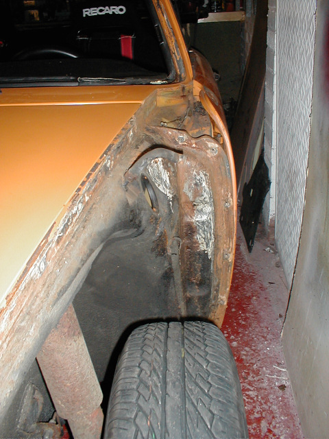

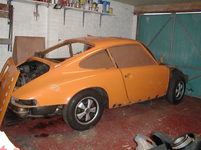

Front wings off
Front wings off
Removing the wings revealed some rot..jpg (454.24 KiB) Viewed 143954 times
Nearside support was slightly worse..jpg (412.38 KiB) Viewed 143954 times

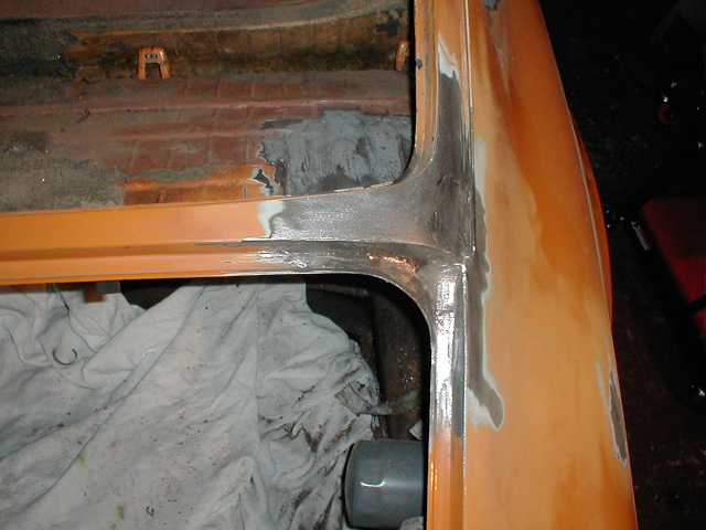

The cause of the windsceen leak
O/S A pillar base
O/S A pillar base
N/S A pillar base
N/S A pillar base

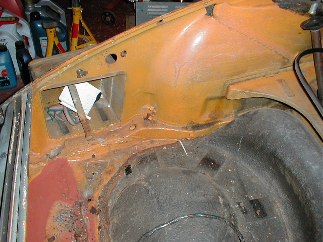

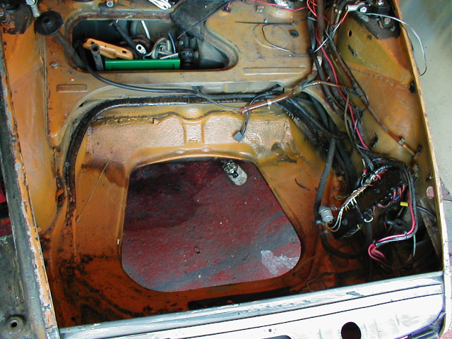

Luggage compartment
Luggage compartment
Fuel Tank out
Fuel Tank out

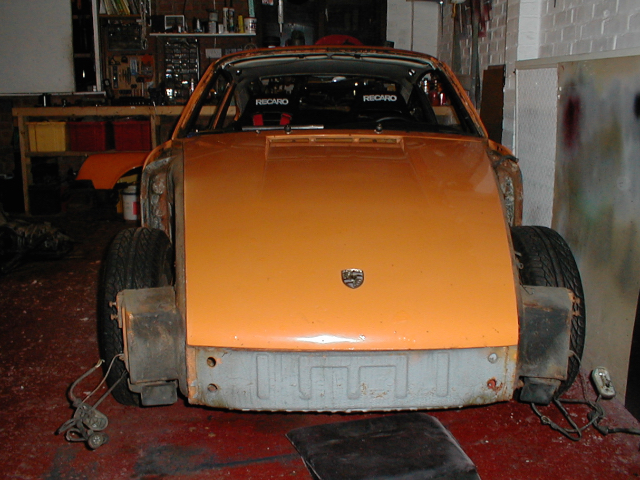

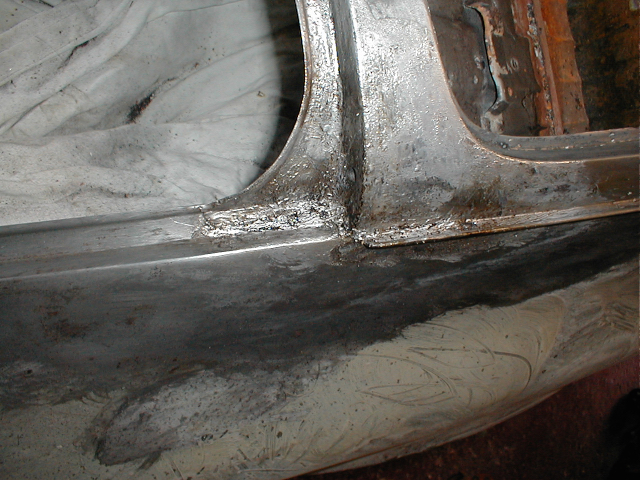

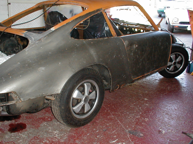

I had sufficient doubt about what may lie beneath the rest of the body, that I decided to strip it back to bare metal.
Stripping the paint thankfully didn't reveal too many horrors

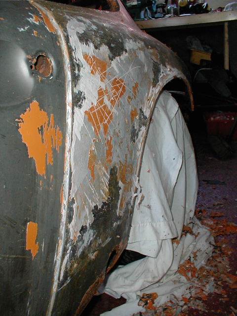

Evidence of a prang
Evidence of a prang
A layer of filler from some minor accident damage.

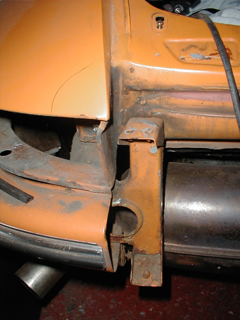

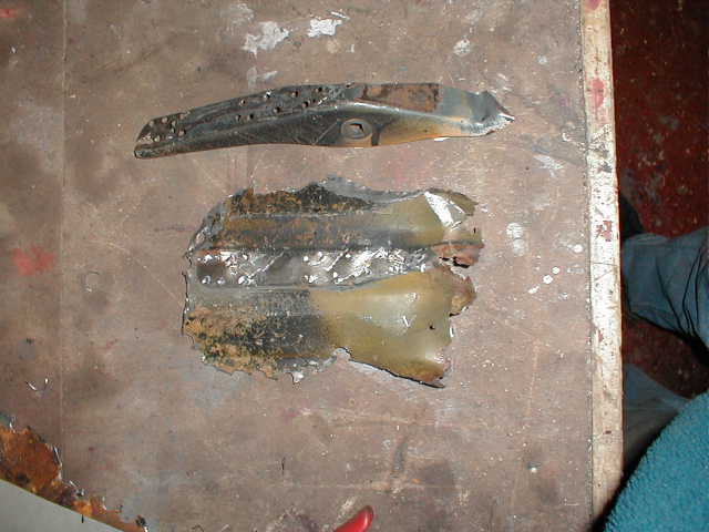

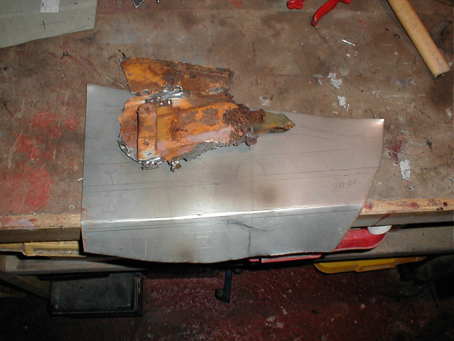

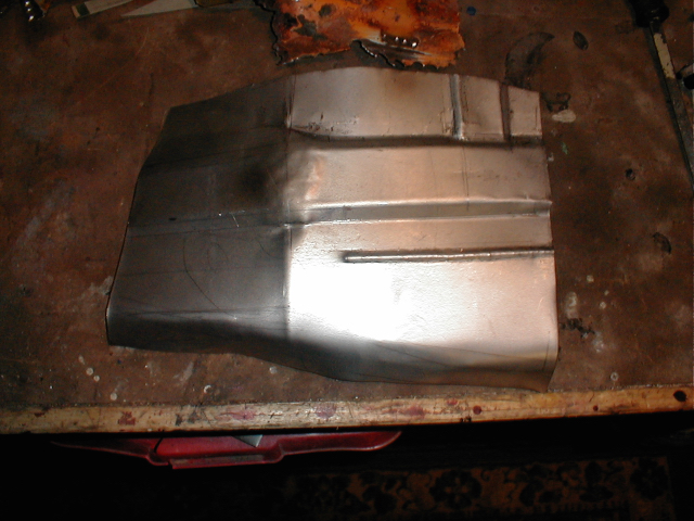

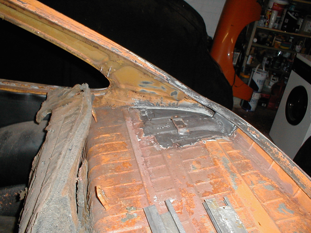

Here are some more pics, starting with the repair of the rotted out corners of the rear parcel shelf.

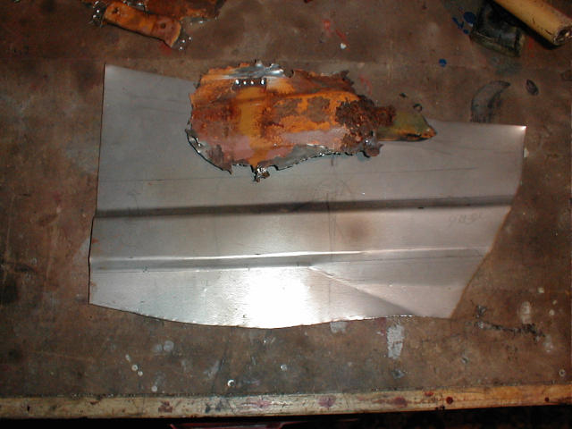

Trying to figure out what the shape the original panel was from the remove section. The separate bracket spot welded to the panel is the mount for the luggage strap.
Starting to form the shape of the original pressings as best I could. I removed the luggage strap bracket to replace on the new panel.
Shape nearly there
Shape nearly there
One of many trial fits, gradually pulling into shape and place with self-tappers

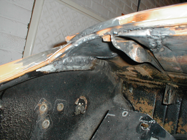

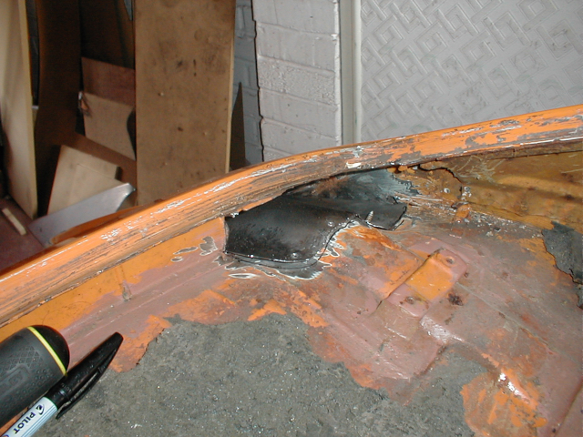

The rotted sections also have the engine lid hinges spot welded to them on the underside. So these had to come off too.
Finally welded in place and the luggage strap bracket reattached.

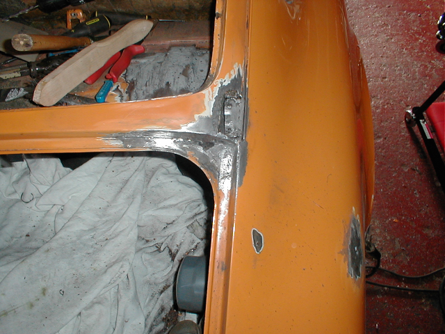

With the shelf corner fixed, I could reconstruct the internal seam. Its quite a complex area where several panels (shelf, inner wing, rear wing and roof, sunroof drains) all meet. Its apparently a 'rear wing off' job in many cases.

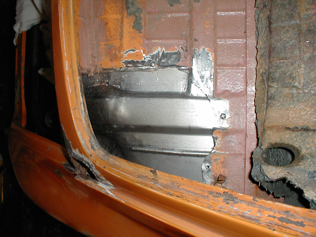

Final repair section tacked in place
P2230011 (1).jpg (394.34 KiB) Viewed 143930 times
Welded and cleaned up.

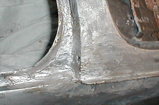

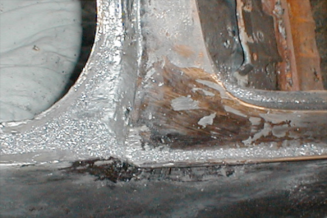

This is one of the areas that was lead loaded at the factory. So I decided to do the same. This is applying the tinning, the brown areas are the flux
P4120011 (1).jpg (414.26 KiB) Viewed 143930 times
Smoothing off the lead (wooden spatular and tallow used)
Filing lead to the correct profile

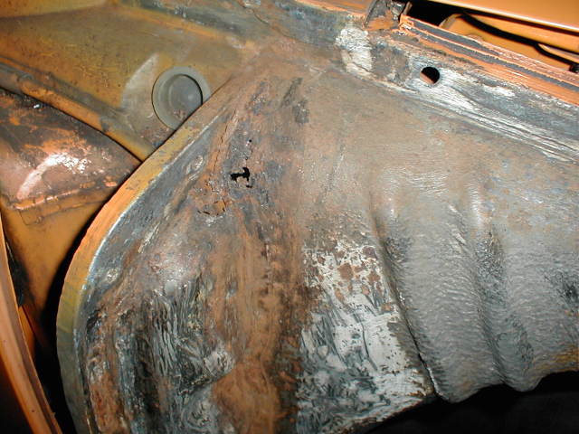

Another classic 911 problem area the inner wing supports. The O/S was reparable:
The N/S was too far gone so needed replacing:
Reference measurements before removing the old panel.
Panel removed
Panel removed
Rot cut out of inner wing
Inner wing repaired
Inner wing repaired

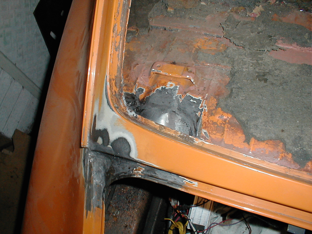

The so called 'Smuggers Compartment' also needed a bit of attention to its surround. It is actually where an optional petrol heater could be fitted.

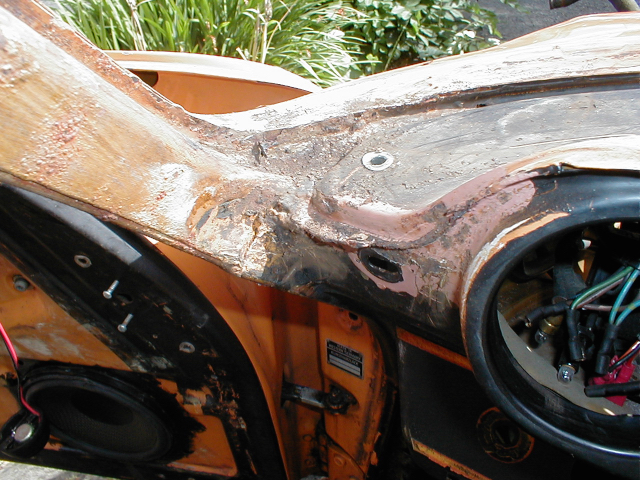

The screen pillar bases were the main source of the water leaks.
Apart from a small repair to a hole on the O/S sill that was about it for the welding. So I moved on to stripping the rest of the paint.

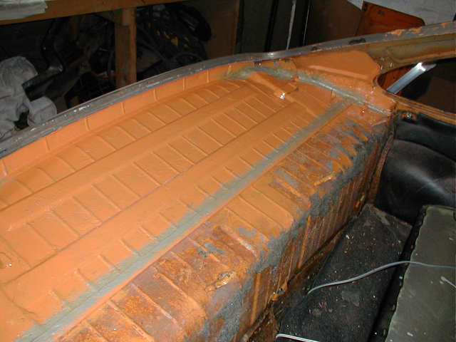

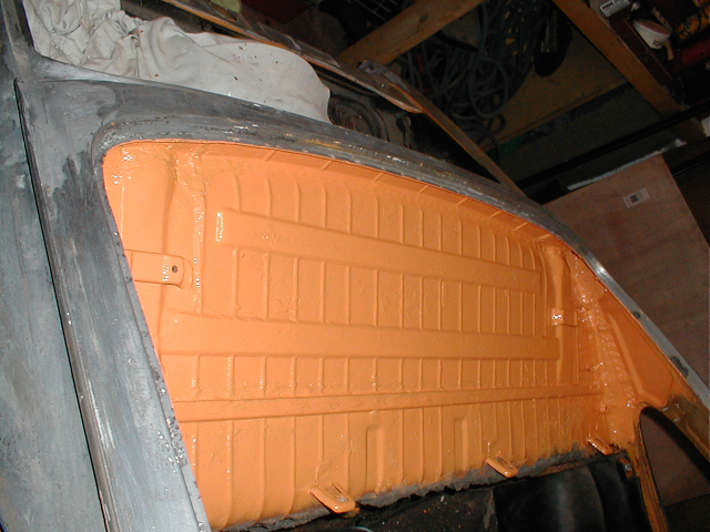

With most of the luggage compartment and inner wings repaired I prepped and painted it in Smooth Hammerite. I could have waited and painted true body colour, but wanted to get it all protected. It's all covered by sound deadening and carpet anyway. and the colour is close enough.
