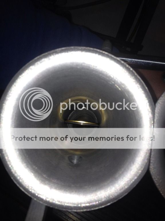

I finally got around to making my inlet manifold, it took a bit of fiddling around to get it to match the 92mm centres I specified on my fuel rails but my perseverance paid off. I wanted to start from scratch with a new flange and new runners but I couldn't find anywhere that could make tapered and curved aluminium tube, and I really didn't fancy trying to make curved tubes by lobster back cutting straight ones so I cut up a standard intake plenum and used the runners from that.
As luck would have it the tubes were spaced almost perfectly for my needs but they aren't 100% parallel to the head as they have a slight dog leg offset for some reason, but it's very slight so hopefully it's effect on airflow will be minimal.
Here's the fuel rails fitted, to get bonnet clearance I may have to run one or possibly both rails underneath as space is tight.
