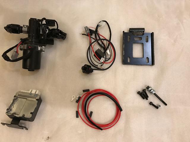

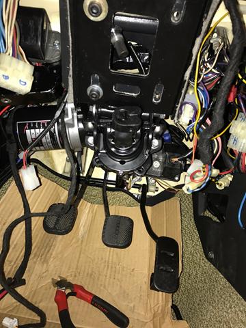

Recently I have found under the Christmas tree the power steering unit made by EZ Electric Power Steering for my car.
The Good Angel, whoever are you - thank you very much !
I am installing it now.
I wish You Happy New Year 2017 !
