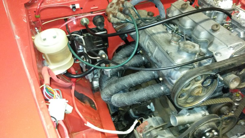

The existing 4-2-1 manifold has been fitted but a new 2-1 section was manufactured by a local exhaust company as the old one had been damaged on the stages. The manifold has been wrapped, but will also require some shielding as the brake master cylinder is very close to the manifold.

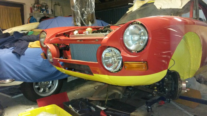

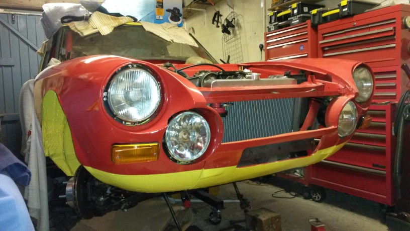

The front indicator lights were sourced from a 126. A bit of fiddling and mounting screws altered and they fit ok. The rear bulb location has been waterproofed.

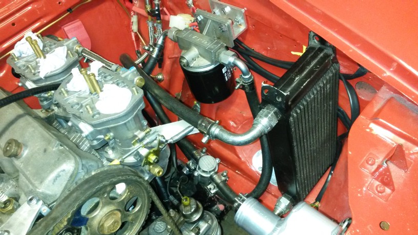

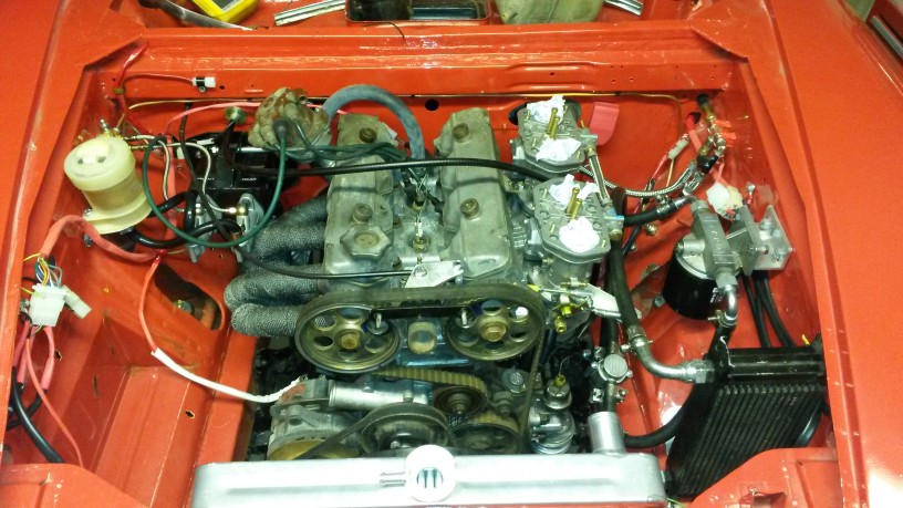

Finally got the old 1608 engine in place (partial strip down, new seals, gaskets belts, oil pump check etc.) . The bearings and rings were perfect, so it was bolted back up. As stated – this will only be used to get the car on the road. I wont use it in competition.
All of the wiring and piping in the engine compartment is in (except for oil catch tank and rad overflow bottle.) It all now needs fastening in place. I tested the fuel system piping with water (plus additives) just in case there were any leaks. All sealed perfectly. ( you can bet if I just put fuel in it would have leaked like a sieve!) . All filters were then replaced.

Question- using remote filter. ( as seen in pictures) where do I take the oil temp and oil pressure from? Standard is oil pressure gauge sender is on top of engine filter take off ( next to oil pressure switch.) Can this remain or is at the remote filter better? Where is the best place for the temperature? I know it is on the return, but is it better at the filter take off or should I put an extra connection and add it into the pipe run ? Only down side- more joints.

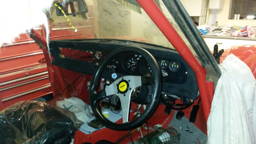

I had located the drivers seat some time ago. ( fortunately with only 2 bolts holding it down. ) We then decided to put the co drivers seat in. Not an issue. Then we tried it with helmets on.
A couple few issues- head touching roof- and head touching side roll bar!. ( well I mean head with helmet on. ) Also what do you do with the helmets and Hans device between stages? There is not a lot of room in a Spider!. With high back seats with side wings- there is just enough gap to get a helmet between the 2 seats into the back of the car. The helmet box wont fit- so I think we will have to use a net. Not sure about the Hans devices- we will wait and see.
Having now looked again at the seat position we now seem to be a little better, although with the required padding on the roll bar- my head is close to touching. With the seat adjusted to its lowest possible setting, there is around 20mm gap to the roof. I am hoping to get another 10 mm or so when the gaskets are fitted to the edges of the hard top. Only other options are to modify the floor cross member under the seat, so the seat can go lower. This would work- but my view out would be more restricted. The other option is a put a “bump” in the roof. Used in racing in the past- and relatively easy with fibreglass. We will wait and see how it goes. Co drivers side is a little easier as his seat can be at a slightly different angle, to give more head room. If not- get a shorter co driver. ( only kidding!)
Next job is exhaust ignition and then fire her up. Windscreen scuttle is now being assembled, with consideration of extinguisher and cut out positioning. Also, the scuttle/bonnet fastening is being looked at. (I remember the pictures of that 124 Spider crash).
As normal with these projects- what seems like a good idea at the beginning turns out to be a problem. In the picture of the dash- there is a 52mm hole in the centre part of the dash. This was for a volt meter. Good idea- except- it is right in line with the ducting for the demisters, so a normal depth gauge will not fit. I have sourced a led gauge- very thin and will fit into the space without a problem.

As for oil pressure take off location I would take the standard position as this is as close to the engine bearings as you can get. For oil temperature take there are in line adaptors available, see photo below. Also I would advise to use good quality mechanical gauges as the electronic ones are not reliable. There are some post about this subject on this forum. Adaptor and top quality gauges can be supplied by Guy.
