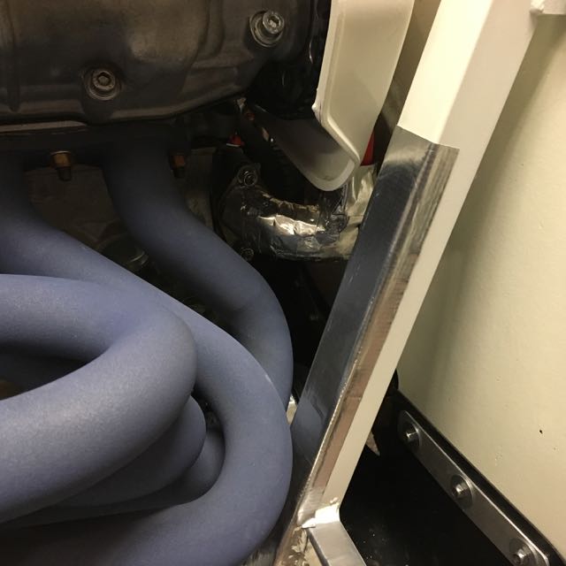

Here are some photographs of the fibreglass modification to the rear clam bodywork to accommodate the exhaust system. I now have a good 50mm plus of clearance between the exhaust headers and the bodywork. After a good few miles driving I checked the bodywork temperature and 52C was the highest I measured so I am happy with that.

- Header to boot bulkhead clearance

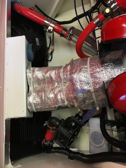

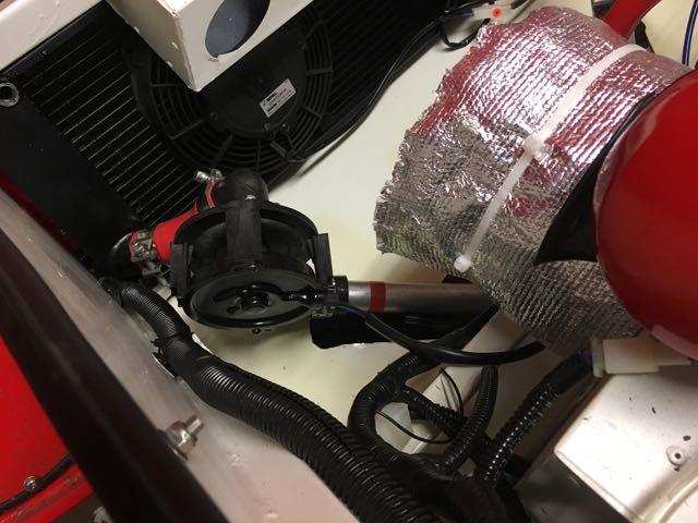

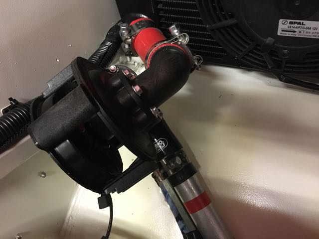

I have finally resolved my over heating problems. I installed a Davies Craig electric water pump (EWP80) in tandem with the MonteCarlo mechanical coolant pump.
I drilled two 5mm holes in the in-head thermostat to enable the EWP80 to run even when the thermostat is closed.
I installed the EWP in the radiator return pipework by the radiator. The pump is orientated such that air cannot be trapped near the pump gland.

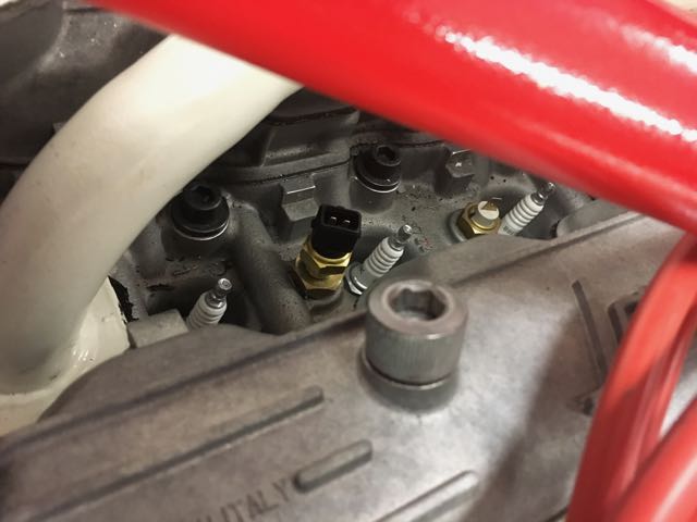

I have replaced the cylinder head over temperature switch with the Davies Craig temperature sensor putting the sensor right at the top of the cylinder head.

I have also applied Zircotec's ZircoFlex sheet to chassis tubes and the coolant pump inlet pipework to stop the exhaust manifold heating the coolant.
- Davies,Craig EWP80 in radiator return pipework.jpg (56.83 KiB) Viewed 145926 times
- EWP in radiator return pipework.jpg (53.77 KiB) Viewed 145926 times
- EWP80.jpg (35.5 KiB) Viewed 145926 times
- Davies, Craig temperature sensor.jpg (65.65 KiB) Viewed 145926 times
