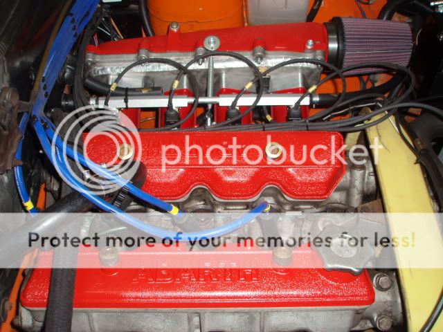

I recognise all the previously mentioned problems, ive fitted an EFI/ECU sysem to my 8V TC and am having problems getting a good set up.
Im following this thread with interest.

Steve - nicely dressed unit but you should remote that filter and get a sealed cold air duct in there.
The red stuff looks brilliant, I do like a bit of color underhood, but you know, now now everyone is going to be asking 'where did you get those?' Esp the bits with A_B_A_R_T_H on them!!
