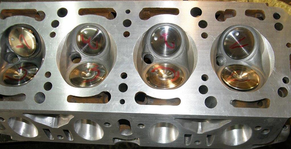

MORE HEAD BUILD PICTURES
Being on a tight budget we had to use whatever we had on the garage shelves:

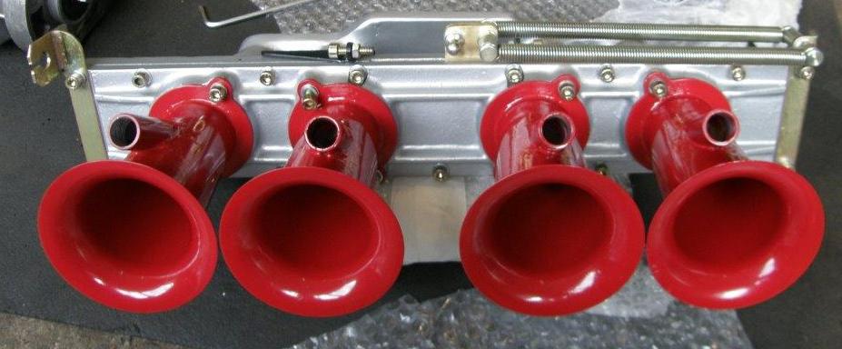

Initially we will put it on 40IDF but ultimately it will run on this baby ...

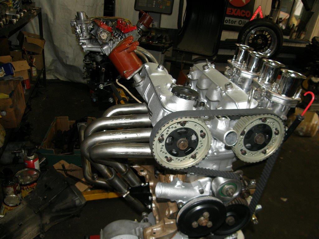

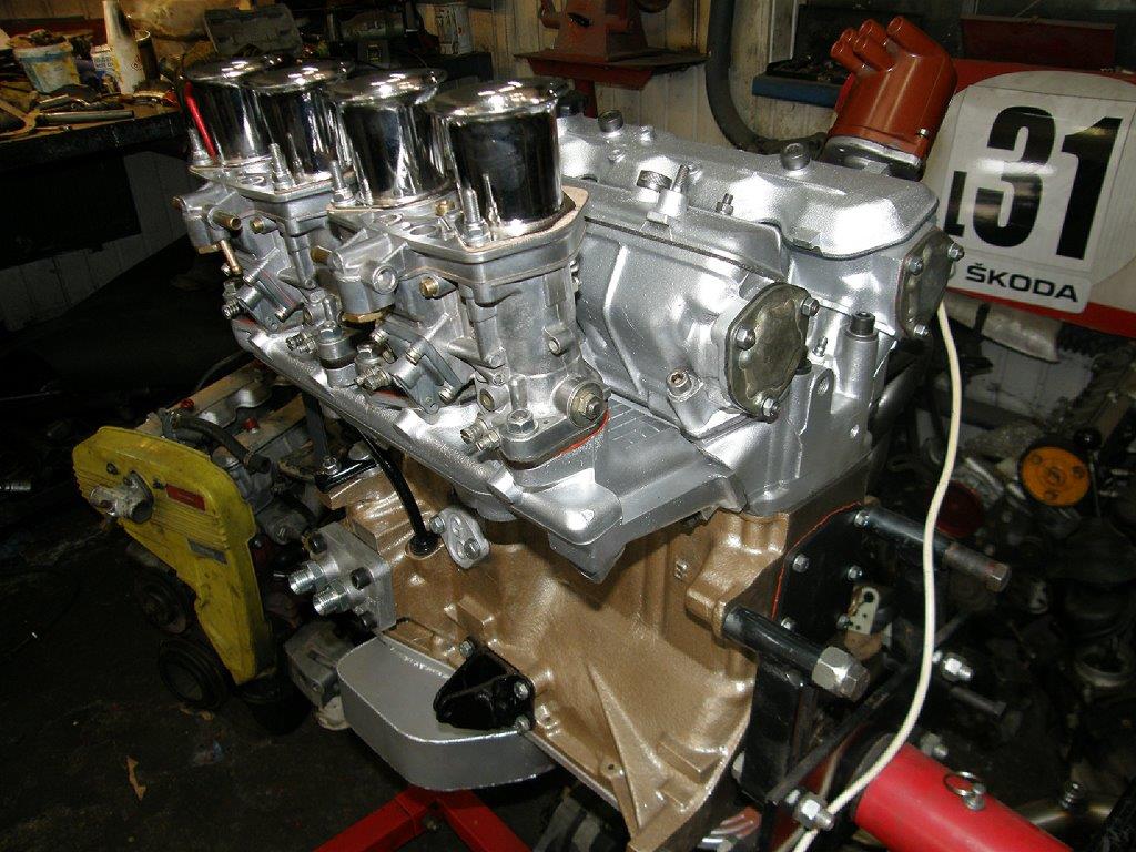

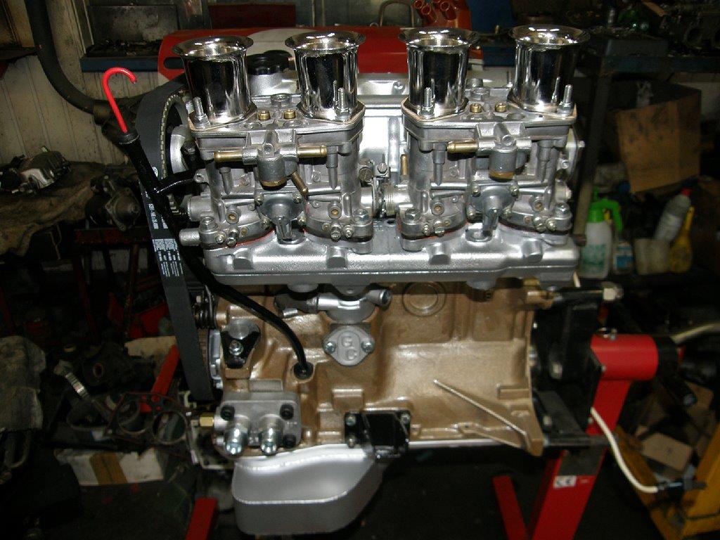

Returning to engine build ...
here is the almost finished engine ...

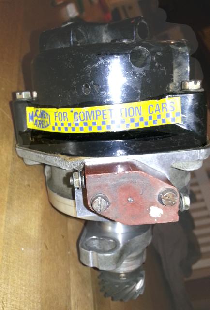

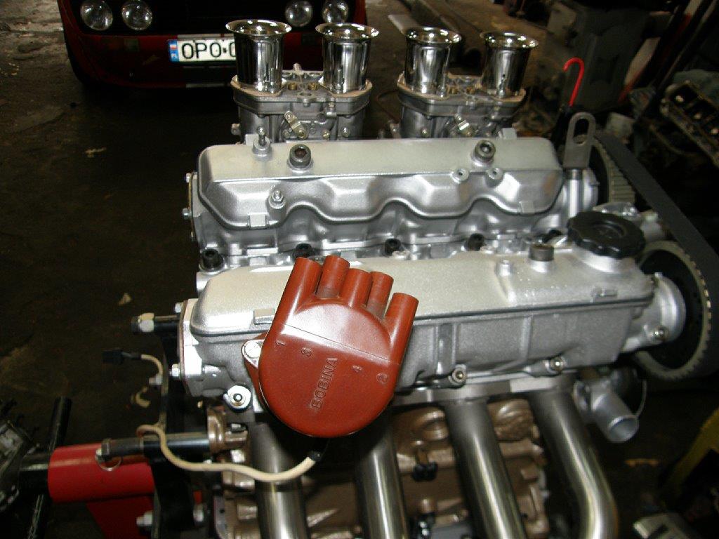

Originally I was thinking about using the original Magneti Marelli AEC 106 Raceplex ignition system with this black, flat distributor on the 124
corsa distr .jpg (39.3 KiB) Viewed 111322 times
but than my research showed that this system was first produced in 1975 , while the configuration of my 124 Abarth is 1973 .. so the Raceplex will go to 131.

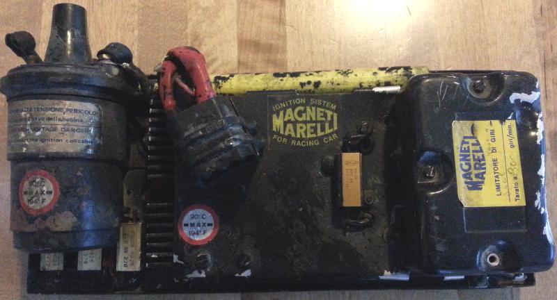

Incidentally, research showed that this system was standard factory equipment on 131 Abarth Rally Gr 4 ex-works and many Ferrari 312 , 126 modals and Lancia Stratos Turbo Gr 5. No wonder it is so hard to find.
The coil and electronic system that went with it was a rather curious, early electronic age device with large transistors diodes, etc., and included a Magneti Marelli designed rev limiter, tacho connection etc.
Raceplex ignition .jpg (52.71 KiB) Viewed 111322 times
I think that instead of rebuilding it we will try to replace it with simplified (not so complex as the original) system without all the extras.
Anybody knows what 1973 vintage part can replace its functions and meet the specs ?
PS: Our distributor is NOS , never installed in pristine condition, but with no pictures of our part yet I used the pictures from Marko's - my Finish friend's page http://www.131abarth.com. Incidentally very worth visiting.

Looking good Miro. Why 40's? CSA ran on 44's. Can you share the rest of your engine specs?
Keep it up.
