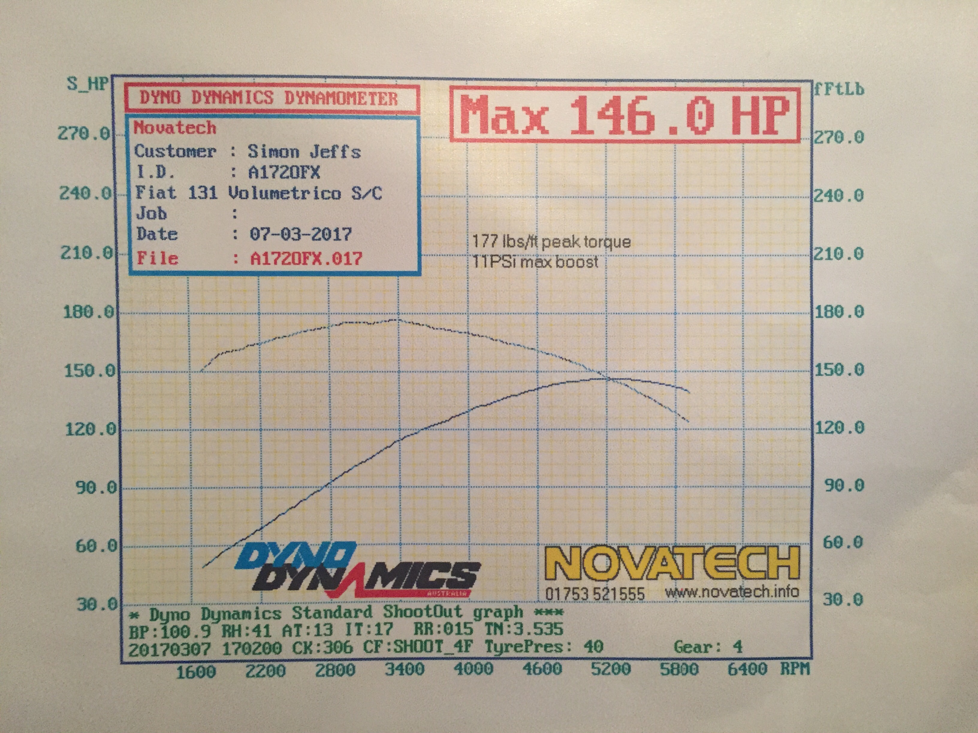

The car was tested again today. Main jet size increased from 195 to 226.
Max advance increased from 26deg to 30deg only increased max power by 4hp so we backed it off to 26deg.
The results were not as good as expected but then this is a completely standard engine with standard carb, standard cams, no porting or gas flowing and a standard cast exhaust manifold so I am not complaining.
Hope this is interesting.
Brgds,
Simon
Brgds,
Simon
GC 133

Simon,
You do have some nice torque out of that baby.
150 LbFt at 1,500 RPM and 177 LbFt at 5,000. That is a tree stump puller !
Add a Weber DCOE, some cams and exhaust and it will rev also.
Great looking car.
Tom
Great looking car.
Tom
