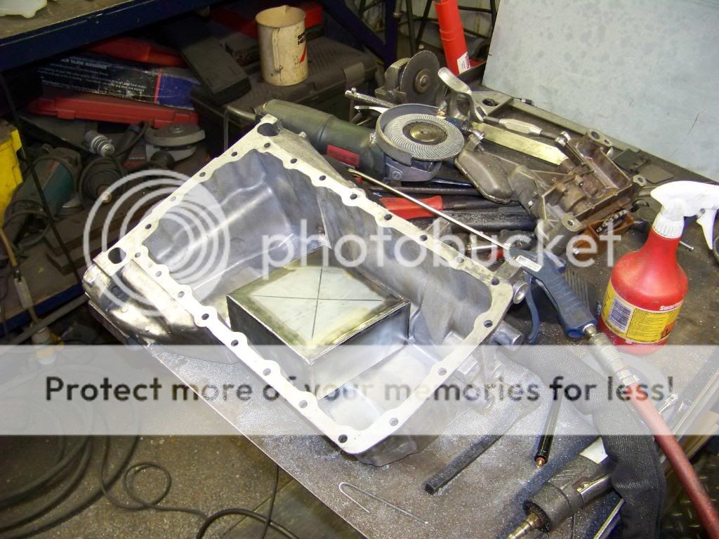

Due to a very hectic workload I have'nt done much to the car at all over the past 4-5 months, however once a particularly long contract ended I have been able to free up some time and get a few things done to it. Firstly, I have decided to make a start on my baffled sump kit. This entailed removal of the existing rudimentry stock baffle and gate arrangement. However, the only plasma cutter available to me at the time had rather a cumbersome torch head on it and I managed to pierce the base of the sump (Not a problem as the TIG set was handy) but some of the flying sparks damaged the thread of the oil drain plug too. Easily fixed though, I drilled out the thread and welded on an AN-10JIC fitting I had left over from something else.(This may come in handy later on as a return/drain down from the oil-breather/catch tank)
Then I knocked up an enclosure for the pickup, this will have suitable gates and baffles affixed to it, space is very limited however as the pickup and pump are very bulky items.

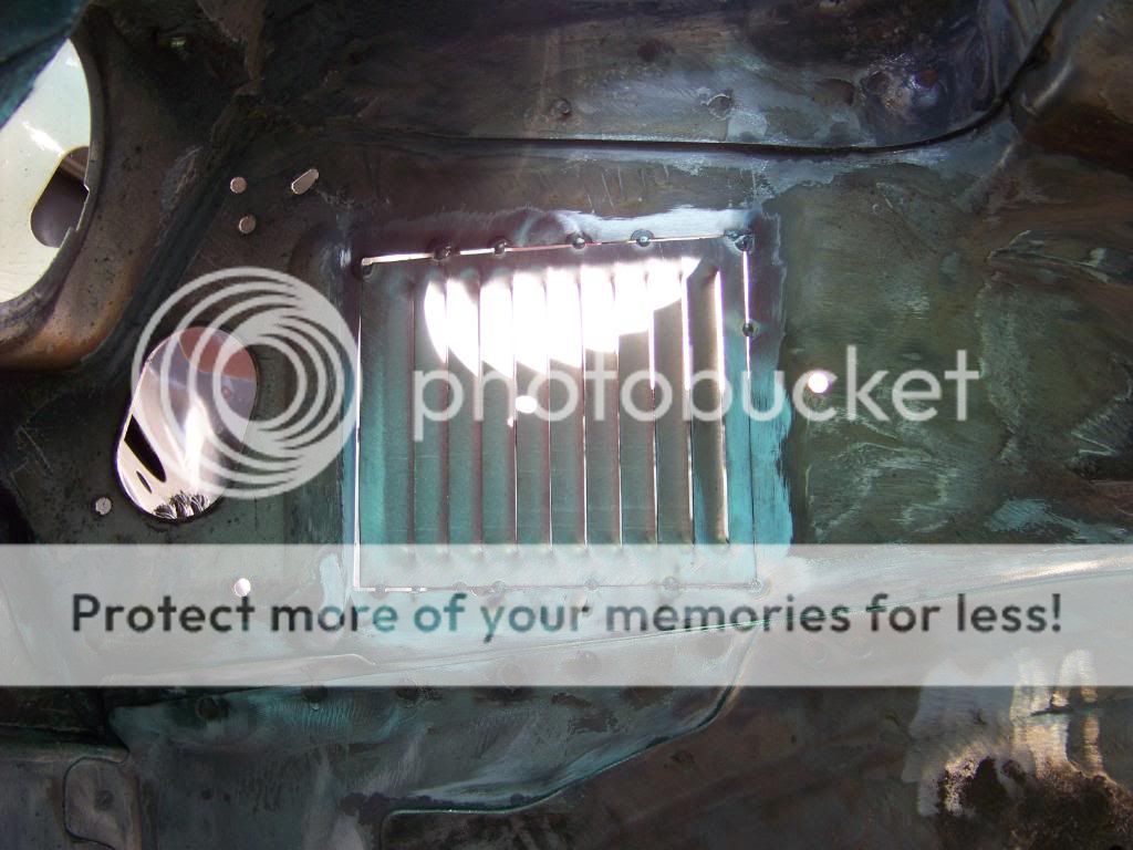

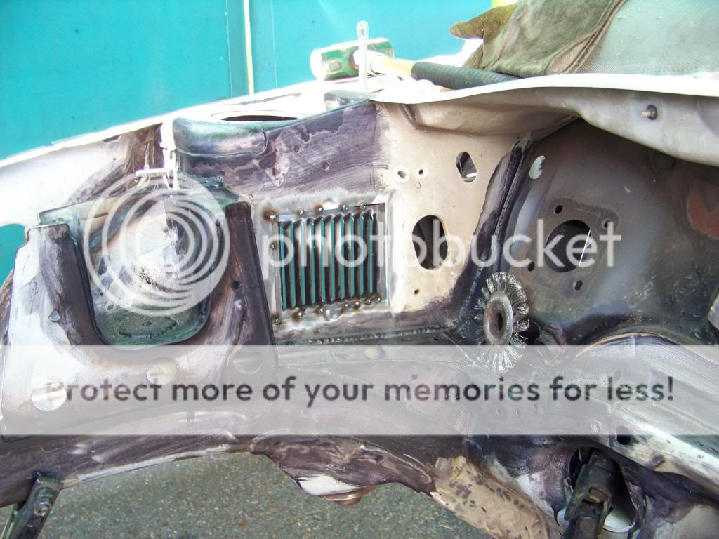

That's as far as the sump has got for now. Progress on the car itself has been happening too though. I have been attacking the rust and carrying out a bit of seam welding. And due to reading Miro's efforts on engine bay cooling as well as Mr. Crofts workshop manual I have made a start on some measures to help expel some of the trapped hot air I expect to have at some point in the future...

I cut some louvres out of some old scrap panels off a welding machine as they were a perfect size for what I had in mind...

Made a little headway tonight on the sump baffle kit, space is really tight so I've had to revise my initial plan slightly (Make it up as I go along ;) ) This involved cutting the sides off the box and welding on some new ones that fitted the shape of the sump base a little better, this will allow me much more room for a nice free flowing trap door arrangement to bring oil to the pickup on righthanders. I have a plan for how to get it to work for lefthanders but you will have to wait and see that. Anyway, here are a few shots of my contraption.
The oil pump is screwed to the wooden baton to get it to sit at the right height more or less for the mock-up.
There is a protrusion on the oil pump body just in the wrong place that fouled the box, so I had to let in a corner piece.
Fitted much better after...
There is also a dogleg section that drops away on the sump floor, this created quite a gap in the corner of the box which could allow too much oil to escape away from the pickup under cornering, so I covered it up with the addition of this plate. It has a drain hole right in the corner so it won't hold any cruddy oil when the time comes to change it.
Still have to make dividers and gates etc. but it's coming along, what with that and this Accusump I think oil issues should be the least of my worries. Paranoid much? I think so!
