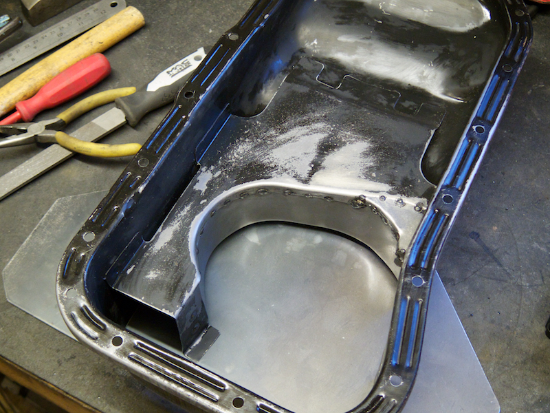

In the meantime I have started work on a big wing sump as I want to get all the dirty fabrication out the way before cleaning everything up for the build phase. It's a composite of the various designs in Guy's books and the threads on this forum.
The old battered sump pan
I cut about 20mm off the height based on the details in Guy's book. I ran some insulation tape around the perimeter as a guide for the air saw.

Next job will be to tack the oil pickup in place, reposition the oil return and start looking at extending the interval baffle to enclose the pickup.

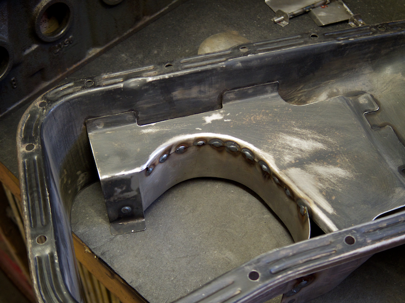

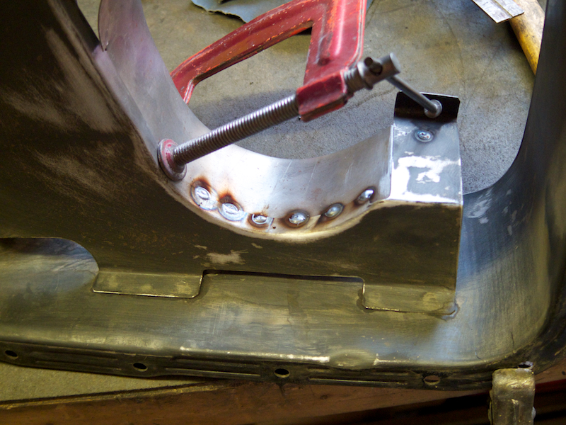

I made a bit more progress today by adding tacking the oil pickup in place and starting on the internal baffling.
Tacking the vertical baffle extension in place
Checking baffle and pickup height. I left an 8mm gap as Guy suggests.
Small section added to extend the top baffle, picking up on the trapdoor hinge mount. This will need a bit of fettling when I reshape the oil return tube.
Still need to drill some vent holes for the side boxes and make up the tops of the boxes, by have now run out of steel!

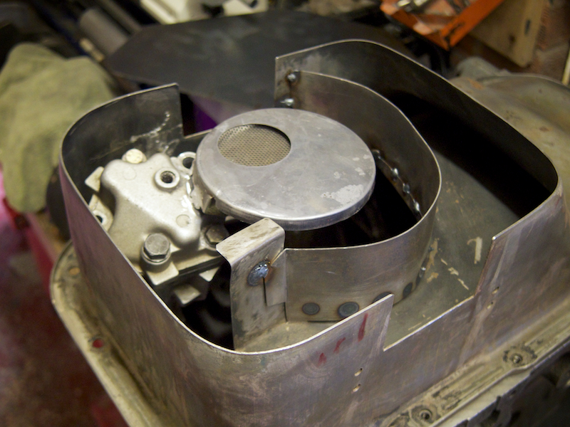

I spent today trying to finish off the fabrication of all the sump parts ready for taking together.
Self-tapping the wing side in place so I could make templates for the box tops.
Cheap profile gauge was very handy for tracing the curve of the sump sides.
Refining paper template before transferring to steel
Checking the fit against sump profile
Near side is a lot curvier than the off side
Air holes and scallops added. I decided to fix the forward trapdoor hinge mounts with M4 bolts to all them to be fitted after painting.
Threaded plate tacked in place
One of many trial fits back on the block
I now have pretty much all the parts made ready for prepping and tack up before welding. Still need to add the drain plug.
