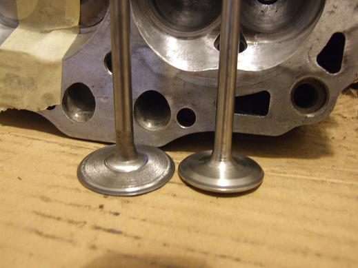

Ported head with 41mm intake 34mm exhaust, 7 mm stem valves from Ford Scorpio 2.0l (valve heads were turned down)

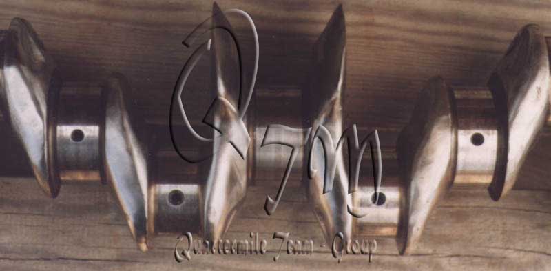

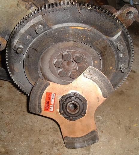

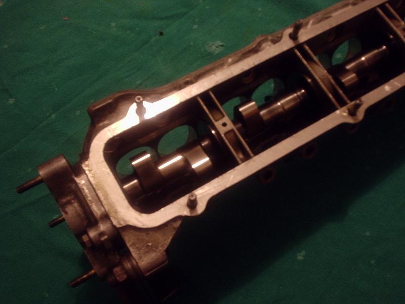

Camshaft and springs: 315‚° CATCAMS
Crankshaft lightened, polished, knife-edged, balanced with lightened fw.
OE standard rods balanced,

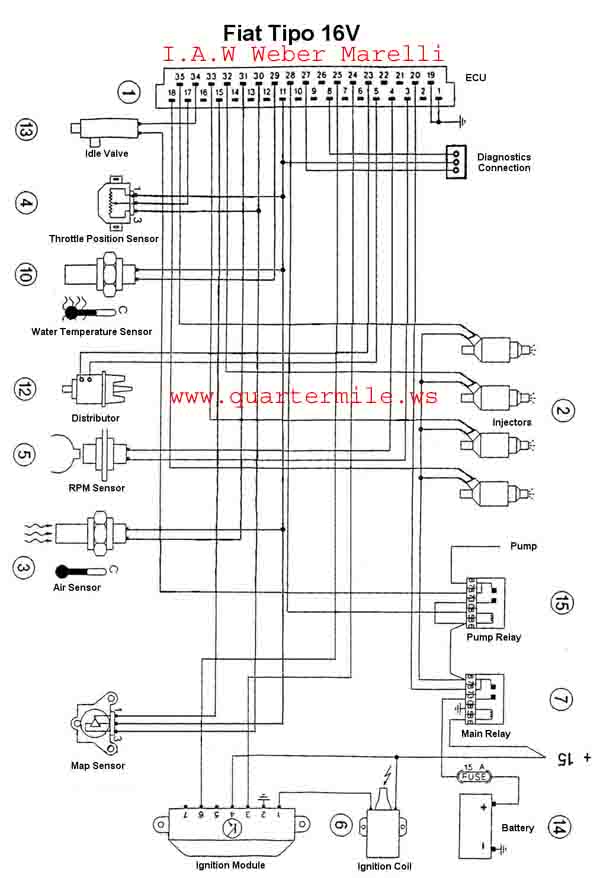

Electronic fuel injection is I.A.W. - sequential Alfa N- link: http://www.rplab.co.yu Nikola Radenkovic (my friend)
support for pencolis link: http://www.rplab.co.yu/
